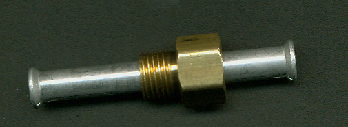

This may be a bumb question, but the instructions in my kit were kind of vague. This is the fitting that came in the cooler kit, and I don't know if I should use it or just cut the cooler lines that are in the car now. If I should use the fitting, wouldn't I still have to cut the line?

Come on... at least flame me for asking a stoopid question. I just don't know if the pressure is too high to cut the cooler lines and use hose clamps to hold the hose on there, or if I should use the cheesy fitting.

just use that fitting so you don't have to cut your tranny lines. Most of the kits come with the 1-piece type of adaptor but that 2-piece might be cheaper to mfg.

If it eases the installation, however, hose will be sufficient. The transmission line is low pressure. Make sure you use an oil compatible hose like fuel line.

Thanks, I'll probably just cut my present tranny lines. I think that'll make it easier.

As usual you all overlooked the "picture", the flairs on are there to prevent the hose from coming off from inadequate tightening. Use two hose clamps. Inadequate tightening does not mean to "overtighten them", it means follow instructions.

Thanks for the help. I'll use the fitting. I hadn't thought about the hose pulling off.
