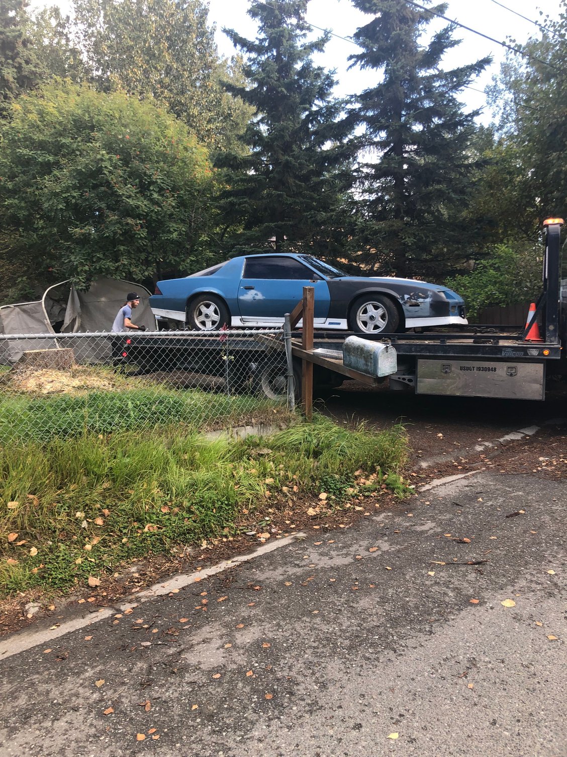

700r4 won’t move after rebuild help what could me wrong
I just pick up this car the guy I got it from Rebuilt the tranny and put it back in the car and it wouldn’t move in any gear He said he didn’t replace the Sprag he think why it won’t move so he put the in the back yard until I took it off his hands what can I check be I pull the tranny
