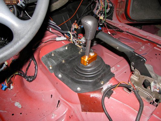

Yes, Scooter is right, use a 4th Gen floor boot. Picture in post #317,,
https://www.thirdgen.org/forums/ltx-...ml#post5967792
Hey thanks Scooter and QT! I have the lower boot from 4th gen but wasn't sure what to do about top I'll look for a T5 Firebird shift plate, pedals - I'm going to look for 4th gen 6 cyl pedals as they do not have gas pedal attached (so I'm told) and should be found in a Pick N Pull for cheap.

I originally had a B&M (Precision?) shifter that came with my T56, but I ditched it because the NVH was excessive. Probably doesn't help that I went with a bronze shifter cup and bronze fork pads when I rebuilt it due to failed 1 and 2 paper synchronizers. Ended getting an old SLP shifter with a modified stock 4th gen stick (just shortened). It's not bad, but I want something with stronger centering springs and I've already done everything I can to the SLP's springs. Been looking at going with the MGW because it sounds like it fits the bill. Plus maybe since takes a round stick for a shifter, it should be possible to buy some round stock and bend/cut/weld/tap the perfect stick.
With a Spohn T56 crossmember and gen 1 SBC, the 4th gen shifters are off a little to the left and rear for me. Not enough that it runs into the shifter plate or anything though, just not centered if you stop and look at it. I do feel that it's a bit too close, as in too far towards the rear of the car. I ended up modifying the stock T56 stick a bit and tilted it forward and slightly right to center it and it's much better for me, but the rubber isolator makes it feel weird with the new angle.
For the shifter plate, I originally cut the old automatic one but I had a hard time attaching a boot to it because the area around the hole was so thin after cutting. The boot retainer I tried to make would randomly detach from below after a while, and would pretty much always require rebuilding if I had to take the shifter plate off for something. I'm sure it's possible to make happen, I just couldn't be bothered to continue messing with it. I wanted it to look clean and stock at first glance so I bought a new reproduction 5 speed plate and 6 speed indicator from Hawks and I'm much happier with the fit and finish and the fact that it's serviceable without having to repair it every time.
I also used a 4th gen lower boot. The ring where the screws go is metal so I just formed it to the 3rd gen floor and ran a few screws in.

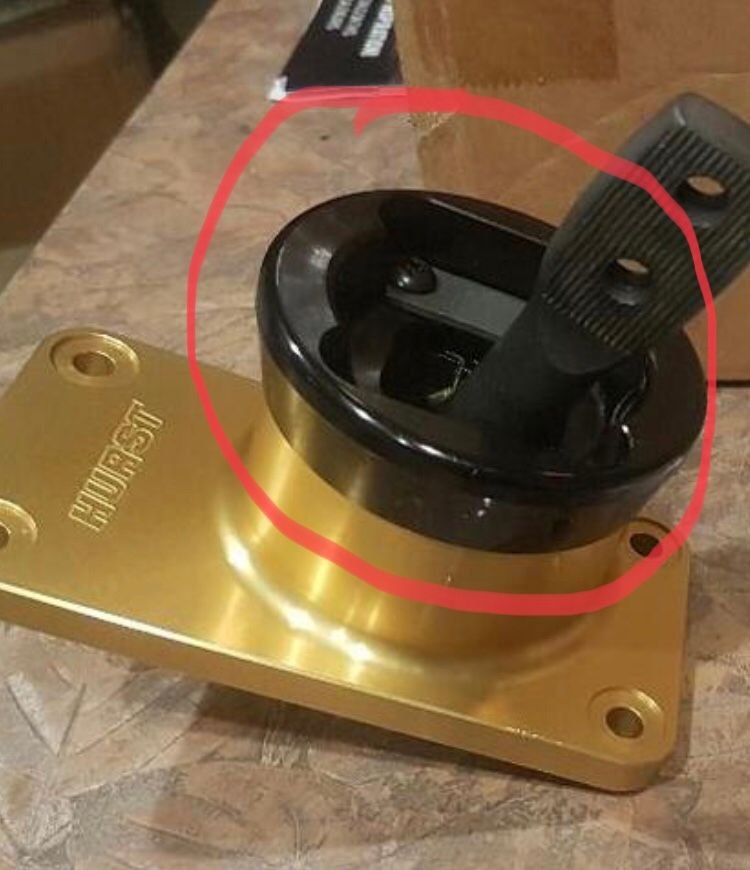

Is there something used to cover/seal the area circled in red or is it ok to leave it open?
On the Mustang, the tower sits high enough to cut the center of the boot, and the boot slips over the top of the shifter, so the open top of the shifter is inside the car.
Some of the stock and aftermarket shifters have a boot that covers the top of the shifter, but most of the modern billet shifters don't seem to.

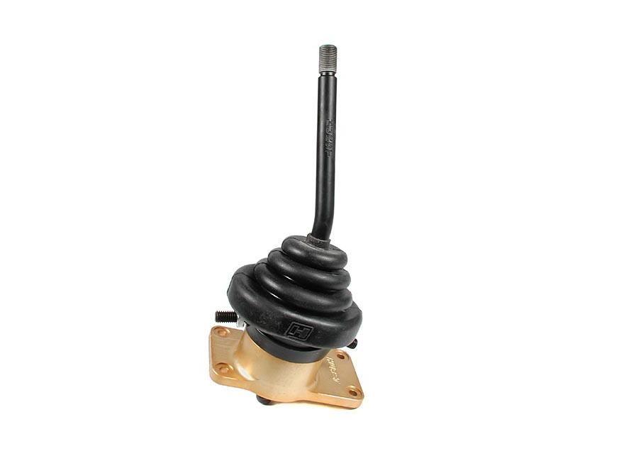

Ran across this on eBay, but I wonder if there's an alternate one with a slot instead of a round hole for that nice Hurst stick unless it's soft enough to conform:
https://www.ebay.com/itm/361427393761

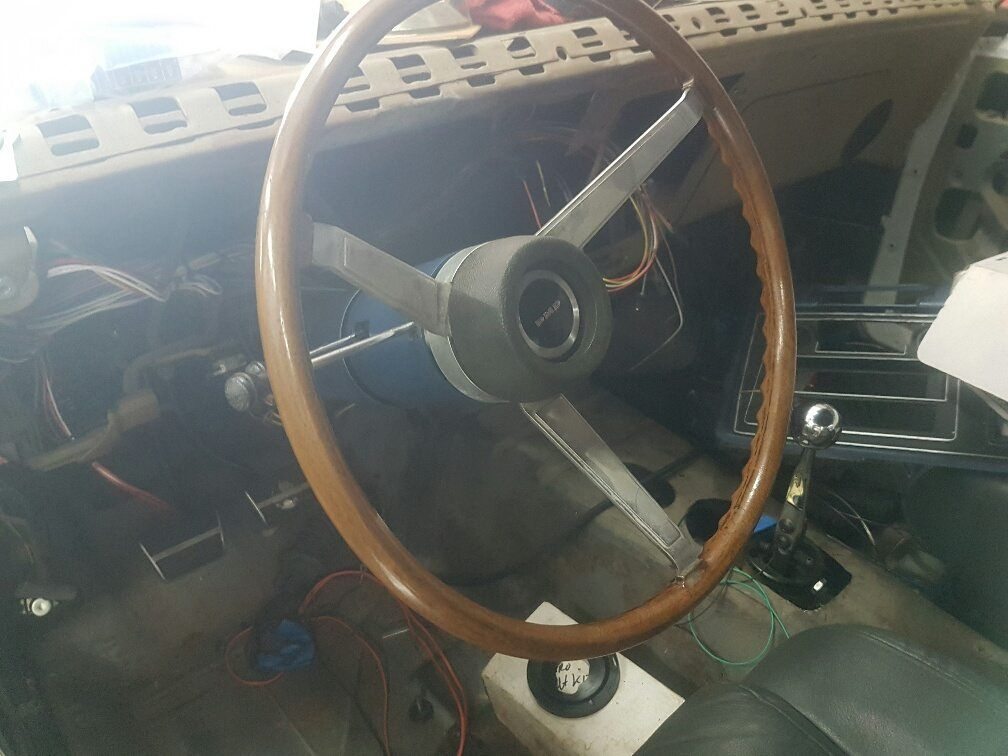

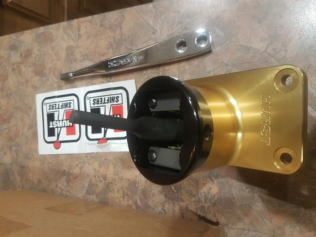

now I'm thinking that the Hurst might not fit under 4th gen boot? I guess this may need to be figured out ?
well after looking back at this pic maybe not I also have a Hurst in my 69
HMM I think its same shifter LOL

You can get that proper boot here
https://core-shifters.com/collections/hurst-dust-boots
