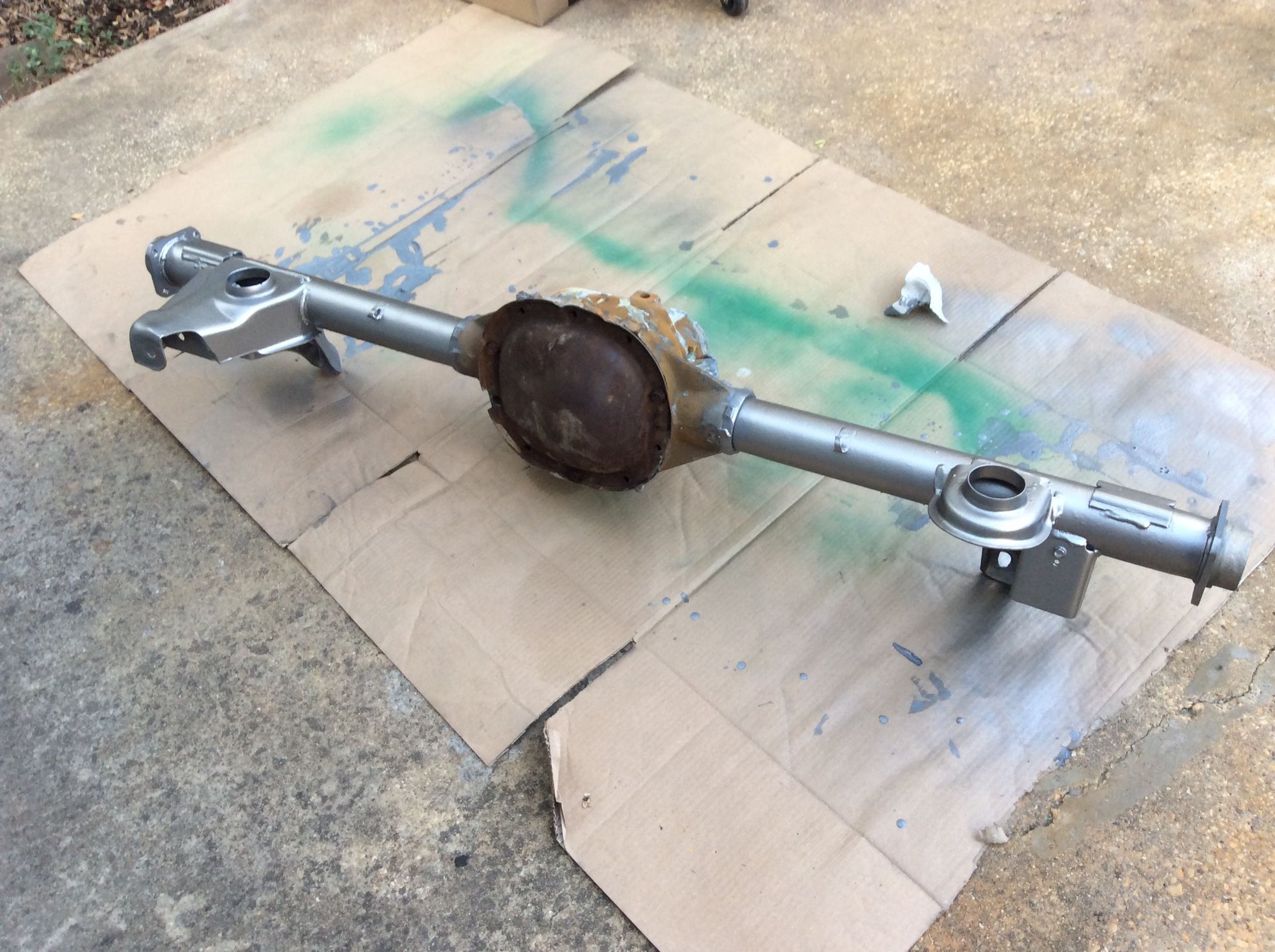

Long steel pipe to bang out axle bearings - what diameter
any of you guys use a long steel pipe and bang out axle bearings from other side? what diameter pipe are you using? concerned about getting them (bearings) ****-eyed in the tube from hitting on one side, and then they'll never come out, is that a worry?

Rent the parts store slide hammer for free when you purchase the new bearings and seals or pay $25 to buy a Steel pipe you'll have no other use for. You also risk gouging the inside of the axle tube with a pipe or smacking your hand or axle flange with the hammer.
slide hammer not available for rent at autozone anymore. last guy probably broke the cheap one they give out. gotta remember, I live in yuppie ville, no one works on their own car around here.
i don't understand why one would hurt the axel tube, a few have mentoned this. lay pipe flat on rag and pound. don't lay pipe at angle and drive it into axle. Or is this easier said than done?

O, so I have an experience and opinion that differs from yours and that makes it "crap" and it means that I've "never done it"
I spent the last two months building a Ford 8.8 center with GM tubes, all catalogued in my build thread. I needed to replace the axle bearings and seals and I saw you spouting off in another thread about using a pipe through the axle. Thought I'd try it. FAIL. Gouged the axle tube. Only on the message boards of the internet will you find someone arguing that the right way to do a job is actually incorrect and a waste of time and the potentially damaging way is the best way. Only on the internet...

I would STRONGLY recommend having the tubes welded up into the pumpkin, both reinforcing the plug welds and also all the way around the joint, while being held ABSOLUTELY STRAIGHT by some sort of fixture, while you have it apart; and of course, BEFORE putting whatever permanent finish on it.
From the factory, those almost always leeeek… maybe not a whole lot or even enough to be particularly noticeable whenever you are working on them, but over time, they always get worse. They just kind of jam the tube in there and then use those 2 plug welds on each one to hold them in; the welds crack, and that makes those leak themselves; then the tubes get loose in the pumpkin, and can move around in there a little, and gradually the leeeeeeks just get worse. A certain amount of the "clunk" that happens from going from forward to reverse, is also caused by this sometimes: the tubes are held in place by one part of the suspension but the pumpkin is held by another, and the change in torque direction turns them with respect to each other. I've actually watched one doing that.
It's also a great time to have LCARLBs welded on.
Like I have said elsewhere, I've had one powder-coated before; that worked out amazingly well. Better than paint, I thought.

I've heard of people welding for strength, didn't know about leaks. I have a bit of a handi-cap, no truck, too much traffic. so I really need/want to go somewhere with something big like a diff, so I'm trying the POR-15 method. I can probably get a welder come to me, but I don't know how to weld. Hoping to learn.
Old Oct 3, 2019 | 12:38 PM
Posts: 27,996
Likes: 2,485
Re: Long steel pipe to bang out axle bearings - what diameter
Not really a DIY welding project. Welding steel to cast iron is best left to someone with the eqpt and experience. Plus, it needs an accurate alignment method, otherwise you'll end up permanently installing camber, toe, etc.
A stripped-down housing may well fit in the trunk of a large sedan, avoiding the need for a truck.
You don't need to weld the tubes to the center housing. If you happen to see oil around the tubes where they meet the pumpkin it is almost always a result of capillary action which isn't caused by a loose axle tube. You would sheer off the pinion teeth or mangle the axle before the axle tubes twisted. Welding axle tubes is more common in the off-road dirt trail world where it can be needed but in our cars the payoff does not outweigh the gamble of finding a competent welder who can also restraighten it after welding. You have three problems when doing this:
1. Your welding what you would think of as normal steel to cast steel. It's not the same as welding plain ol steel. If you tried to just weld it like plain steel it will crack or have a lack of fusion. You need to follow certain steps like preheating evenly to a specific temperature (450° or more) and post heating with controlled cooling. Alternatively you could weld it in short 1" segments but you have to wait for it to cool completely between welds.
2. You have to use specific fillers like a high nickle rod for stick welding or aluminum bronze on AC/DC for TIG welding. This is because you are welding dissimilar metals. An easy analogy is that it's akin to the same problem dentists have with fillings popping loose.
3. Whoever does the job needs a way of verifying that the tubes are still straight. A jig or welding fixture is only meant to hold something in place while welding, it is by no means a way to negate or remove weld distortion from something. As soon as you removed the welded item from the fixture it would snap into it's newly distorted shape. So you need to be able to remove the distortion.
The reasons above are why welding engineers exist
Old Oct 5, 2019 | 02:21 PM
Posts: 27,996
Likes: 2,485
The rear in my 74 Caprice convertible (8½" 10-bolt) had loose enough tubes that I could turn one of them with my hand. Caused a weird clunk when stopping and then accelerating. Needless to say, leeeeeeeked like all hell. In fact the reason I had it apart in the first place was from having got water in it, launching a boat.
The one I put in my 83 Z28 (a 90-91 PBR brake 10-bolt) had one tube loose enough that I could make it move in the pumpkin and change the camber or toe or whatever.
Both of them leaked.
I highly recommend having yours welded up. With a fixture to hold it perfectly straight, and another one to hold the control arm bolt holes straight... you not only don't want to weld them in with some oddball camber or toe, but also not with a twist, which would make the car "crab" down the street.
