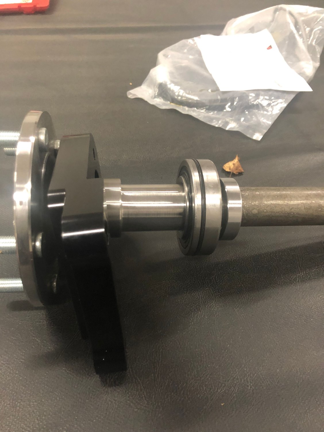

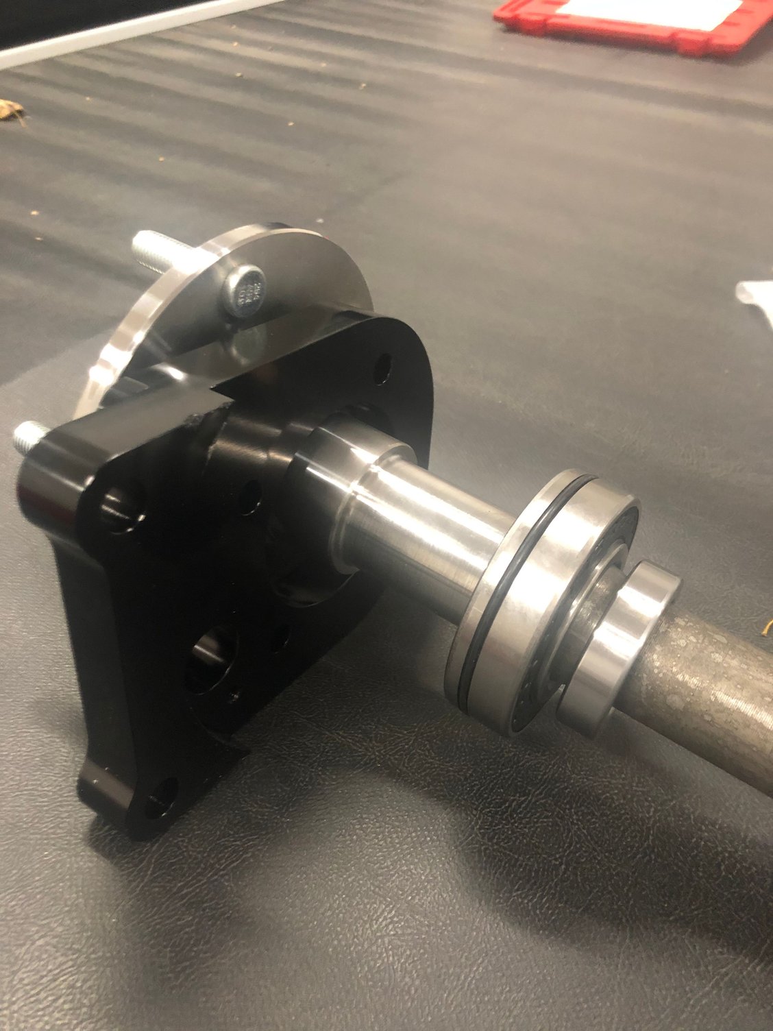

After searching for hours reading conflicting answers, I am hoping someone can chime in here and point me in the right direction.
1990 Camaro convertible
-Purchased bare hawks 8.8 case and moser 31 spline axles and LT1 backing plates.
Before i press everything on.....
DO I NEED A SPACER BEFORE THE BEARING?
My understanding from reading is the LT1 brakes need a 1/8 spacer prior to the bearing and press ring going on the axle shaft. If this is the case I dont know why hawks wouldnt have sent it to me with my purchase. Very frustrated with this 8.8 should have gone S60...

Can't you just get a 1/8" C shaped spacer that will fit over the axle? That way it wouldn't matter when you install the axle bearing or if you need the spacer.

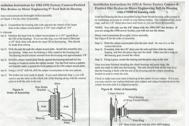

Re: Hawks 8.8 LT1 brakes, moser axles - spacer?
I was thinking of the retainer in my post above. I think this is what the original poster was talking about. Wanted to post this in case someone finds this post when doing a search
