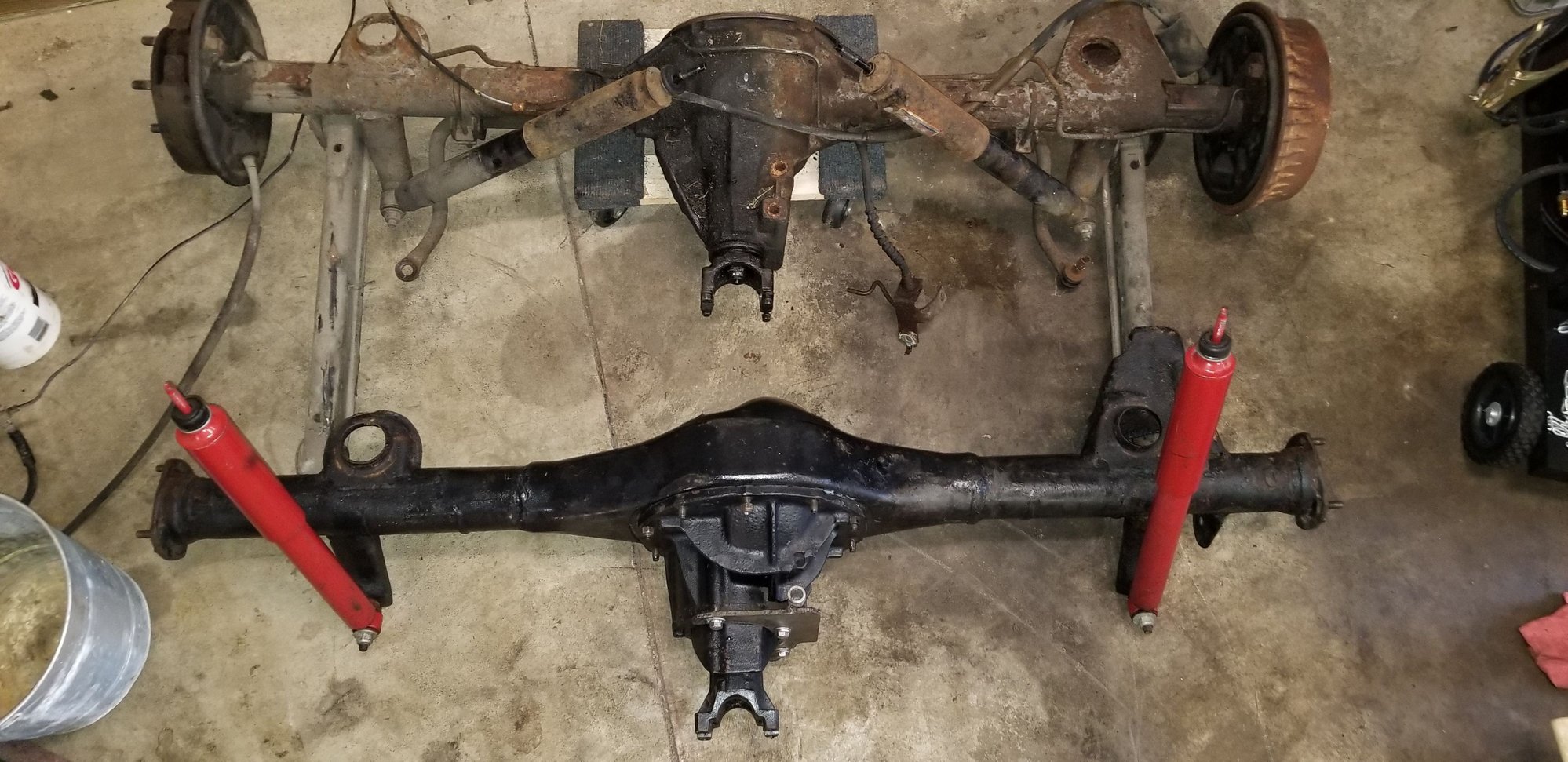

I have a ford friend that rebuilt several 9"s, so I had him help me with this one. He said the yoke is about as long as one that you are going to get. I know a picture won't do much, but I took a picture comparing them just to see if the driveshaft would line up in the tunnel and all the mounts would line up. Also, the pos torque arm mount that is in the center section itself, was put on by the previous owner and is getting removed. I have a Currie one to weld onto it. However, you can see where the stock torque arm mounted onto both rears, and the yoke seems to be sticking out further with the 9" than the 10 bolt. But that is completely a guess at this point.
