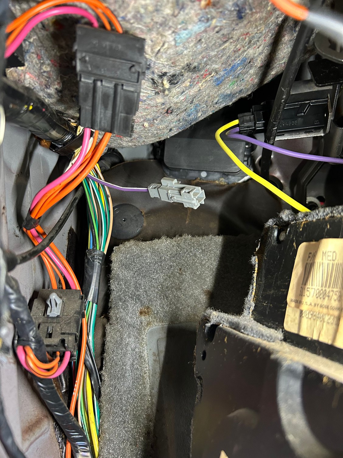

How do I wire the neutral safety switch so my car will start? I did a LS swap with an AR-5 manual 5 speed. I took the cable out that runs to the automatic shifter and can't get my car to start now. Anyone know what to do???

When I manual swapped my car there was a wire harness for the manual trans actually coiled up behind the driver side kick panel. It had the clip on the end for the interlock switch on the clutch pedal. It was a nice surprise. The thick yellow and purple wires are the ones you need from the auto shifter switch (if the manual harness isn't there) If those wires aren't jumpered it won't turn over. I would extend them to the switch on the clutch. You could also wire them to a moment switch. You'll also need to do the same we the reverse lights on that switch harness.
there is also a cable that moves w the shifter that moves the steering column key release mech. For years I left that in a position to let the key to move freely. I eventually got a rebuild manual trans car column. But things all really only related to physical key/tumbler movement and key release.

I will look. Is it the purple with white stripe?
