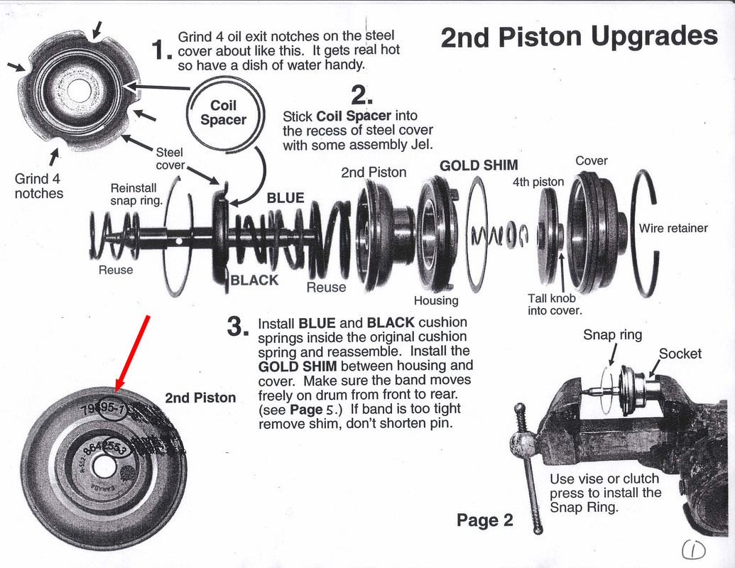

Does the directions mean the 2nd piston as in the servo

Yes, Trans-Go is referring to the 2nd Apply Piston - disregard any other info in the attached image (instructions are for Corvette Servo modifications).

Originally Posted by zupta82
I’m not going with a corvette servo. Are you referring to the hole drilling for the corvette servo
The original question was, which piston your instruction sheet was referring to - the one in the servo? The answer is yes. It's referring to the 2nd Apply Piston.
The image I posted confirms that your instructions are referring to the casting numbers that are on the 2nd Apply Piston (which is part of the servo - not the 2nd Accumulator Piston). Do not follow the instructions that I posted. The arrow is for reference only. Sorry for the confusion. Follow your instruction sheet.
So, look at your 2nd Apply Piston. If it has the "093" or "95-1" casing number on it, enlarge the holes in the plate per your instructions. If it doesn't have either of those two casing numbers, don't enlarge the holes. Don't assume that you don't have a Corvette servo. The Corvette servo is probably the most common mod everyone does to these transmissions.

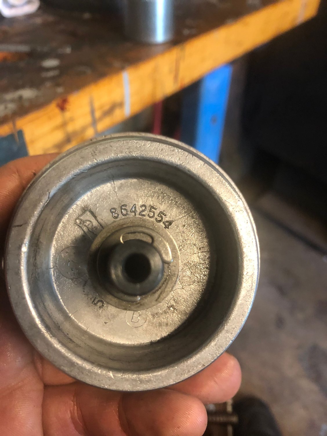

Well I went back and pulled the servo out. I had to mangle the outer blue ring and I had to pull the pump back out because the endplay was about 0.030. I got a couple of days while I’m waiting for a thinner selective washer and new pump gasket because I already torqued it down. Here is a pic of my casting of my 2nd apply piston
