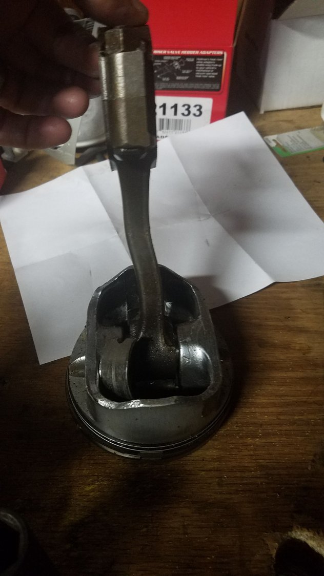

Two years is not necessarily accurate, that's my recent adventure with the car. I bought it back in 2002 and daily drove it. It's been a toy since about 2007.
Recent adventure is a fresh 383 rebuild, T56, to a nine inch. Shooting for mid 11s with sticky tires and a shot of nitrous. Hopefully it goes better than last time! Two bolt main, stock bottom end, whoops. The pic is my actual rod result.

Them be high performace rods....lessens side load on something
