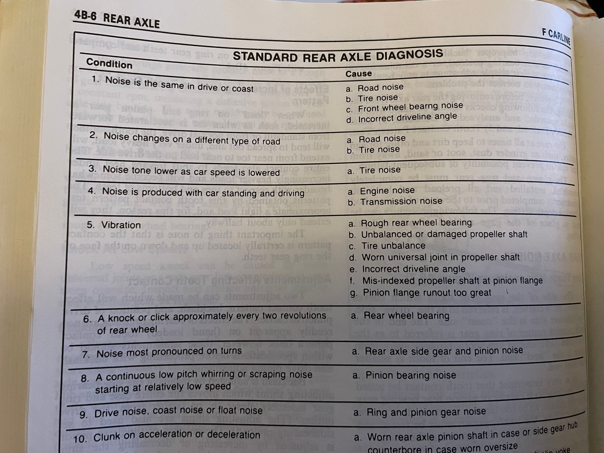

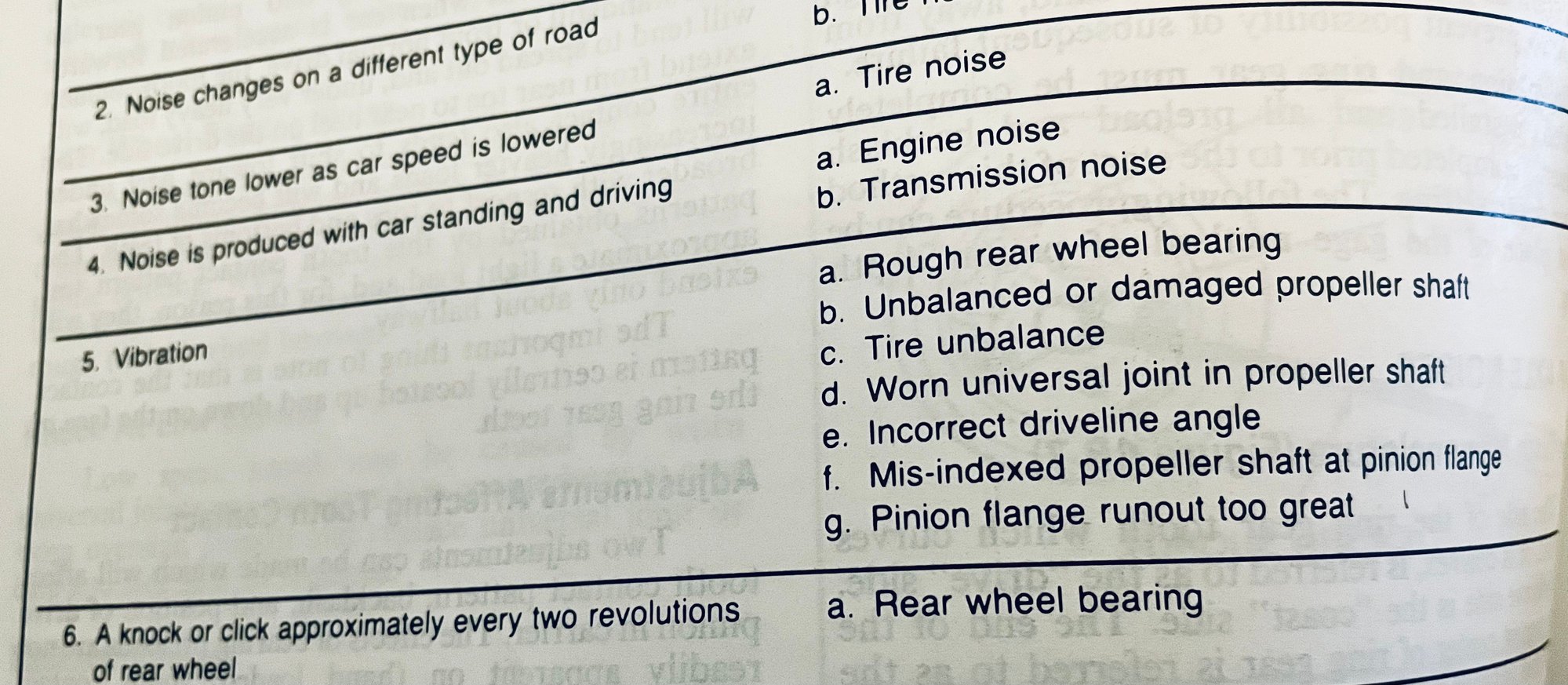

Hey guys,
I have a 1985 305 TPI with a 700R4 with 93K on it and been chasing vibration issues on the freeway about 70mph. Already replaced the driveshaft with an aluminum one from Summit and it's a drivetrain improvement but hasn't taken away the issue. Also changed gear oil and nothing bad in the old fluid. Car sat for 25 years and I did replace rear calipers and pads and check the axle flanges for runout and they were fine. The car was missing the drivers rear wheel and I replaced with factory wheel as was suspicious of a bent axle.
Appreciate any help or guidance from everyone!
Update- Trans mount replaced, new tires and balanced them twice including a road force balance. Reindexed the driveshaft at the pinion 180 degrees. Still there
I’m thinking rear-wheel axle bearings next as GM shop manual lists this as a source of vibration?
