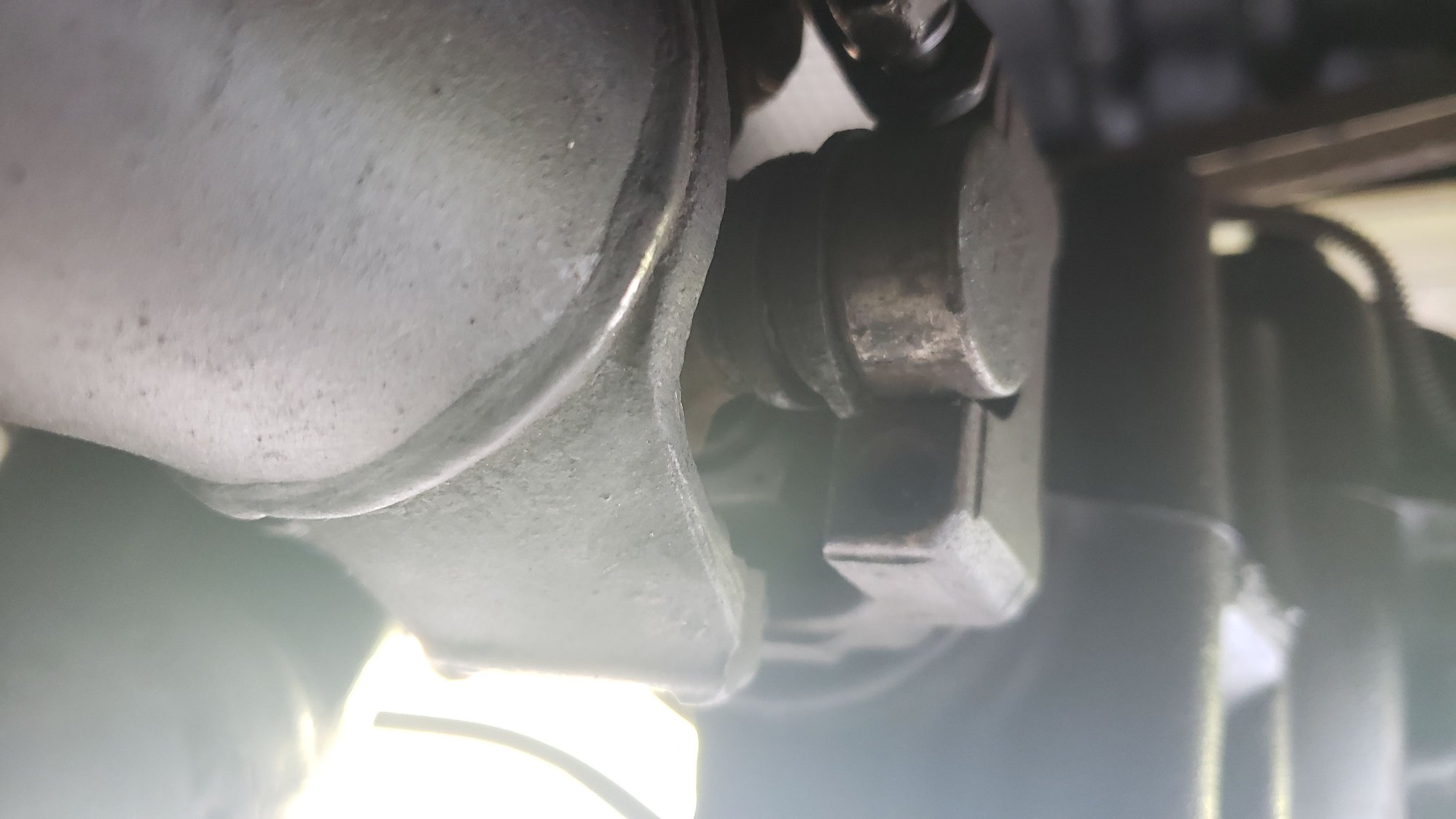

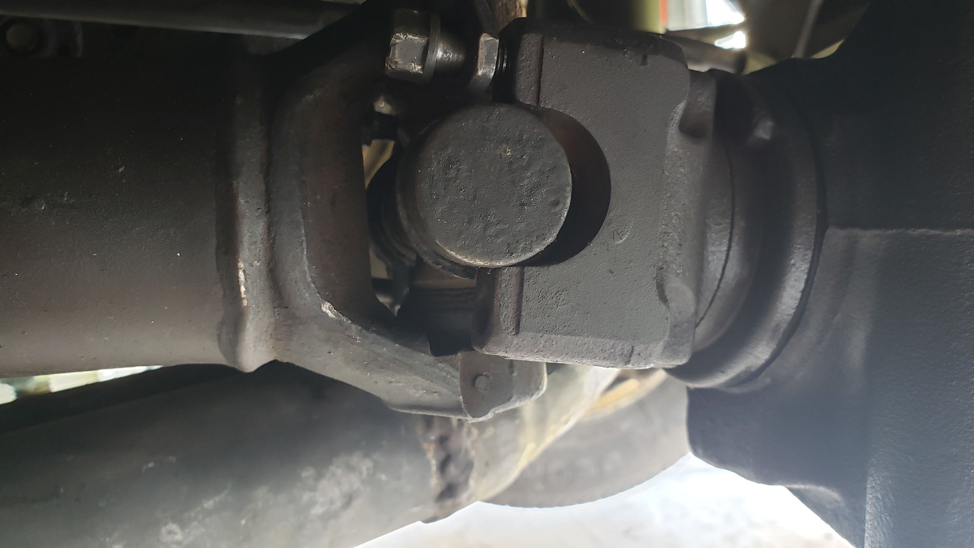

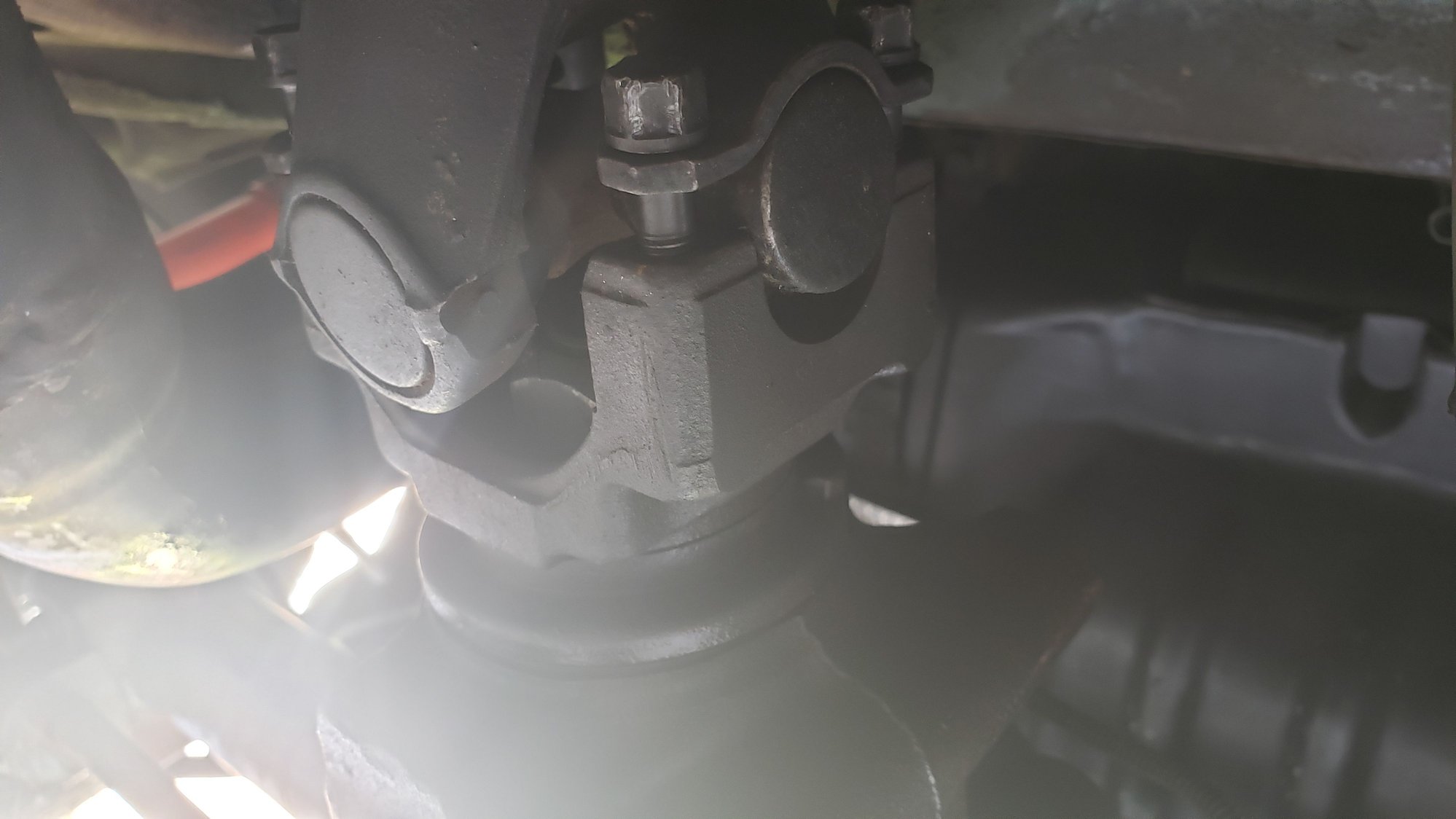

Here's the driveshaft and New diff.
yoke joint diameter is 26mm compared to the old diff which was 30mm.
Looks like I'll need new straps too.
Bolt thread is the same but bottoms out because of the joint not sitting flush and straps not curved enough.

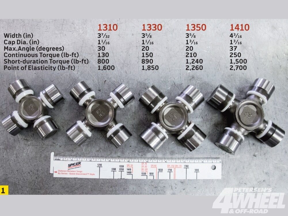

looks like I'm chasing a 1330 to 1350 conversion joint.
Found one at VPW in Australia so I'll give that a go.
