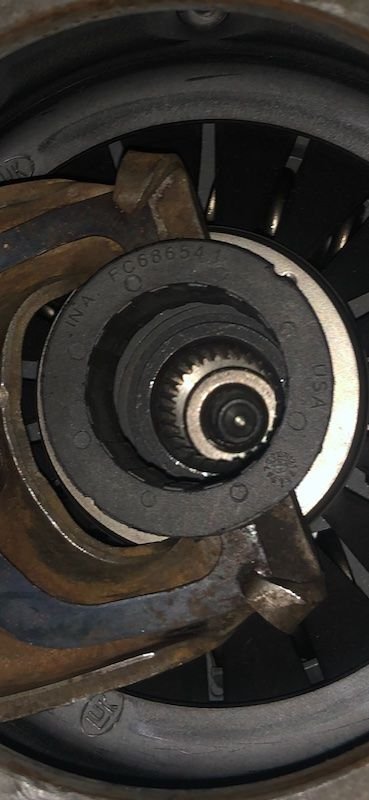

So didn't get much done this weekend but today I unbolted the trans in preparation to drop it. Much to my surprise I find this....Uggh!
Old May 18, 2022 | 11:27 PM
badtenant's Avatar
Joined: Sep 2009
Posts: 254
Likes: 28
From: Dallas, Texas
Car: 92 RS
Transmission: TKX
Re: T5 Clutch Issue
Quote:
Originally Posted by midias View Post
Did you install the thorwout bearing correctly?
Looks to be good...

FML...Well, I figured out the issue other than that cracked bell housing! Chalk this one up to not doing enough due diligence and really inspecting the pictures.
The guy told me he had this running the T5 behind his Iroc and pulled it out to restore the car. So I look and low and behold I have a 14 spline f'in input shaft. Luckily I didn't seem to mess anything up in the process. (Tech Tip...Make sure the clutch slides easily over your input shaft before installing it on the car. Same with throwout bearing)
So what do I do now? I guess I can run the V8 bell housing, pressure plate and a v6 clutch? Change the input shaft? Admittedly I have not looked very hard but how much different are the gear ratios?
Do I just cut my losses at this point and go another direction...Keep in mind this was only going to be for the summer.

Re: T5 Clutch Issue
I think there is a S10 10.5" clutch plate that works

I don't get it. Are you saying the splines (diameter) on the input shaft are smaller than the disk splines? If so, how would that factor into grinding, when trying to put it in gear? If the clutch is disengaging the eng. from the tranny, then when you try putting it into 1st, it still should go in W/O grinding. It "then" would grind, (or slip) when you release the clutch, and try and move the car. Are you sure you're explaining it right?

I might not be explaining it correctly...I ripped it all out anyway and just went with TKX. So far so good...Just need to wrap up a few little things but it is working like it should.
