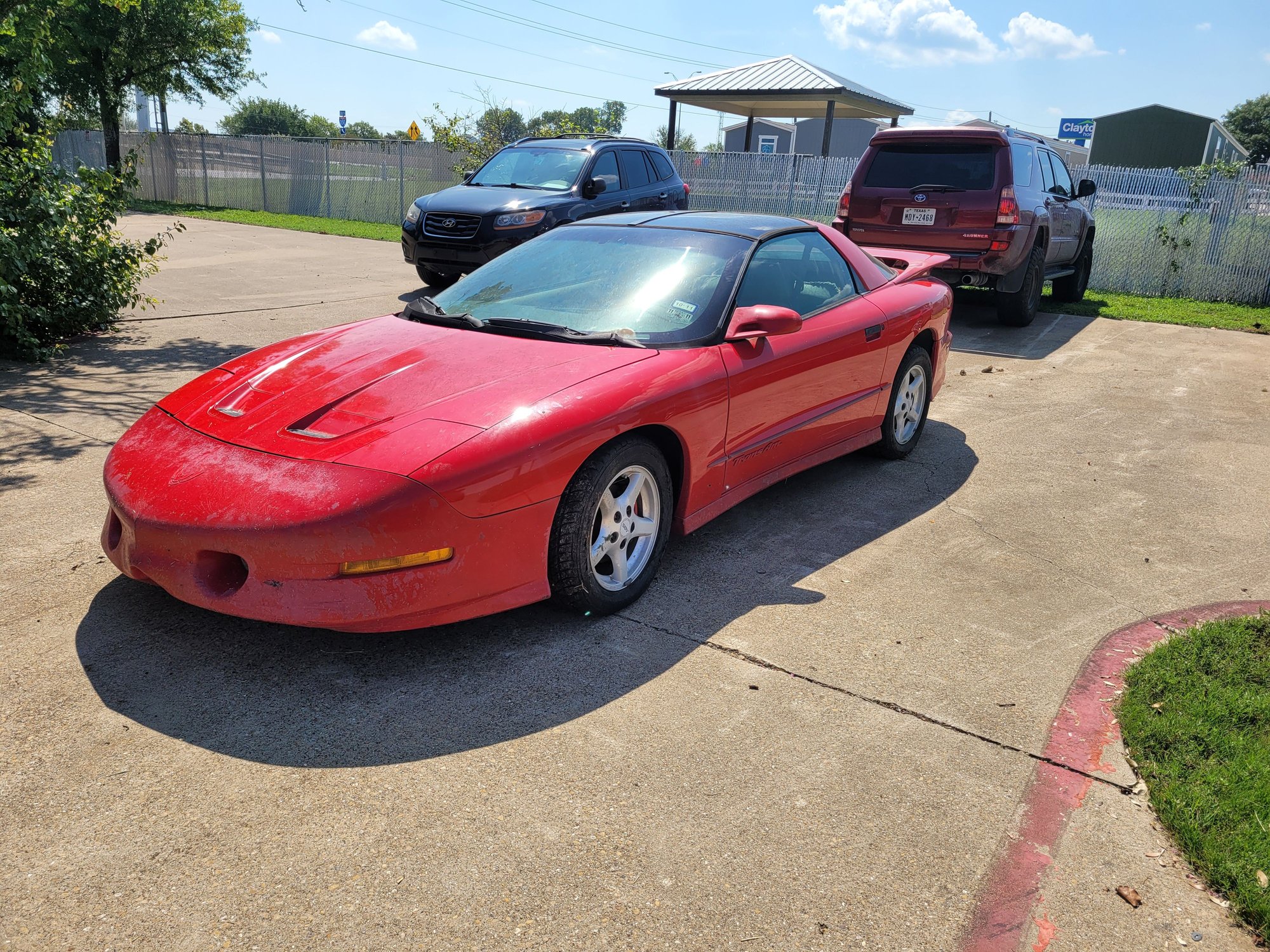

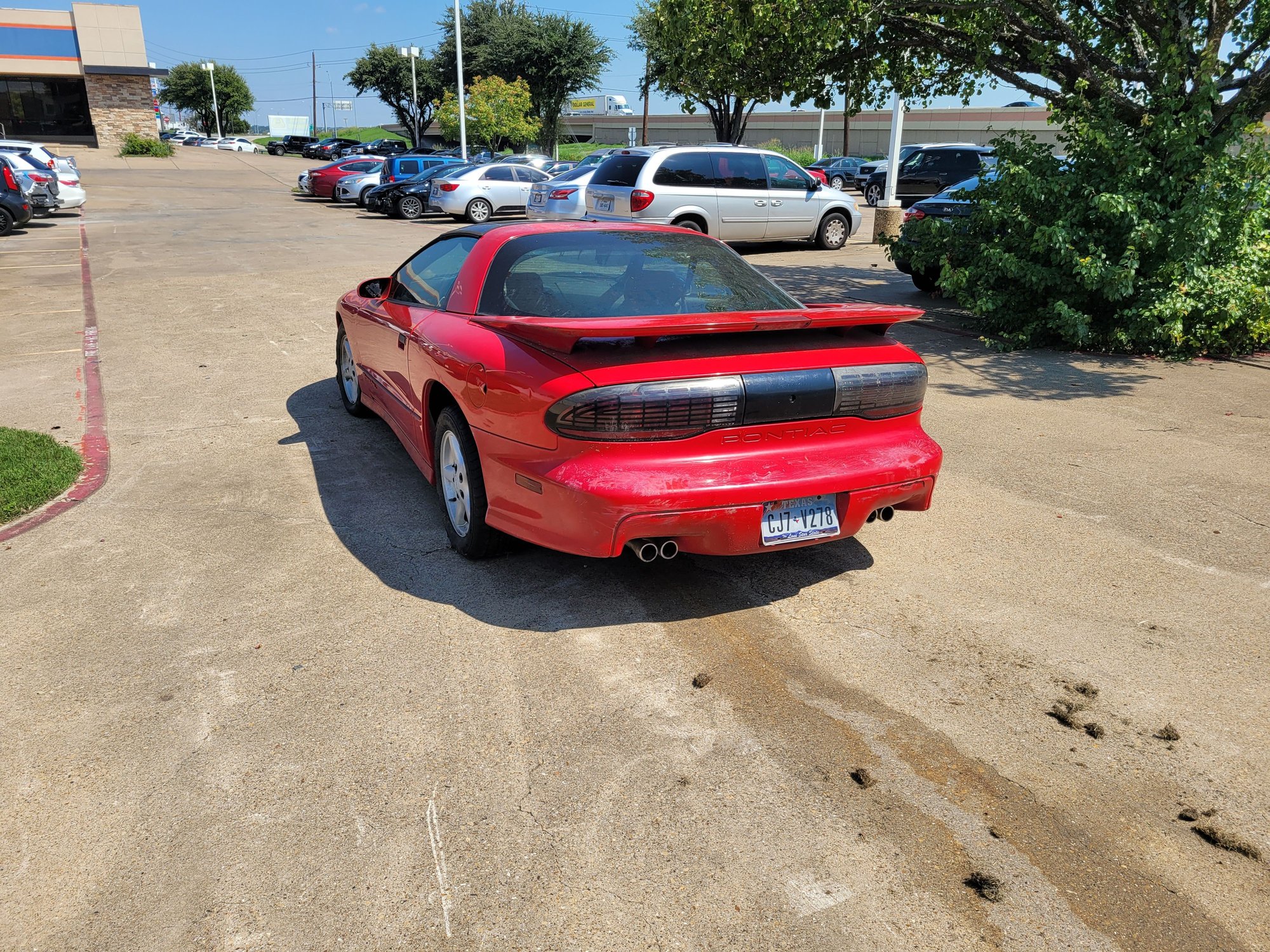

I picked up the parts car today. It's really not that bad of condition. I started it on starting fluid and a jump box. So I would think a fuel pump and tires and it will drive. It's been sitting for 11 years and the clutch pedal is still strong.

Looking at the car today, the fuel tank had a hole in it. The fuel pump was spinning but while I was doing a pressure test I was noticing a whole lot of wires chewed up and missing and some sort of fuel leak at the back of the engine but just as I saw that it caught fire. Luckily I have an extinguisher 60 yards away. It put out the fire. It didn't burn anything more that what rats have chewed up, but it is quickly becoming a better idea to harvest parts off of this thing.

If it's that much of a basketcase, you can certainly part it out and make some money. Stick the T56 as is into your 3rd gen and see how it goes. If it shifts through all the gears and doesn't make weird noises, then just run it. If it has issues, then will need to decide what to do from there.

I killed the fuel pump and hooked up the ole parking lot carburetor to a vacuum line . It runs pretty decent for not having metered fuel. Sounds mean still. Would be nice if someone on here would want to lt1 swap their car. It would have everything they would need.
