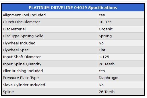

Years ago I changed out the clutch disc and pressure plate on my 83 L69 and didn't have a problem finding one at my local AutoZone. I am looking at replacing the same on an 84 L69 and it appears to be a little harder to find today. It's not your typical 10.4"/10.5" size. It measures 10", 26 spline input. The engine still has the factory lightweight flywheel. I can't remember if my 83 was a 10" or if it had the 10 or 26 spline.
AutoZone shows a 10" but it's not available; can't even order it. Rock Auto shows three 10" kits but in the actual details they all say they are 10.4".
Has anyone tried to run a larger clutch? Will it even bolt up to the factory flywheel?

10.4" 26 spline
No a larger one will not fit, the clutch bolts are on a finite circle, the disc cannot go beyond them.
I see several options on rockauto.com. All pretty much what I would expect. Any problems there?

Yes, a few options but even though the some of the titles say originally it was a 10" size the specs say the replacement is 10.4" or 10.5" and supposedly will fit.
I guess I need to do more searching to see if there is a 10" available.

It was originally 10.4", more or less. Replacements are also 10.4". People call that size all sorts of things. Don't put too much stock in somebody calling it 10" or 10½" and take that as some kind of absolute to-the-thousandth kind of accuracy.
10.375" is less than a business card thickness different from 10.4" around the edge.

But the disc and pressure plate on mine actually measures 10". The flywheel's friction does measure 10.5", however. I'm thinking the larger clutch is what I will be forced to buy. I just hope the bolt pattern matches.

It matches. It's the same size. That's the size they all are. There is no other size.

Original '82-'85 V8 manual transmission cars did have a 10" clutch. GM started phasing in a 10.5" clutch during the later half of the 1985 model year.
The 10" clutch hasn't been available from GM or aftermarket for many years and the parts book even specifies replacing the clutch with a 10.5" unit
on earlier cars.
The bolt circle is the same between 10" and 10.5" pressure plates and the flywheel will accept either size clutch disc. You'll be fine installing a 10.5
clutch on your car. GM's original clutch supplier was Valeo.

Thanks Dens. Your info info correlates with what I have. The 84 I am working on now has the same 8-spring disc you show. Those years you mention pretty much matches what I experienced back when I changed the clutch in my 83. It may have been a few years later when I bought my 10" kit from AutoZone although I can't be sure what the actual size it wound up being.
The only thing I notice is when I change out the disc with the 10.5" it will match the flywheel surface but overhang the pressure plate although I don't see an issue with that. Just the wear pattern on the disc will be a little odd.
Maybe I should get the entire kit. That would make me feel better anyway!
I also noticed the Valeo kit is available AutoZone although it is a 5-spring.

A 10.5" clutch disc is not compatible with a 10" pressure plate. You must replace the entire clutch assembly when going to the larger size.
