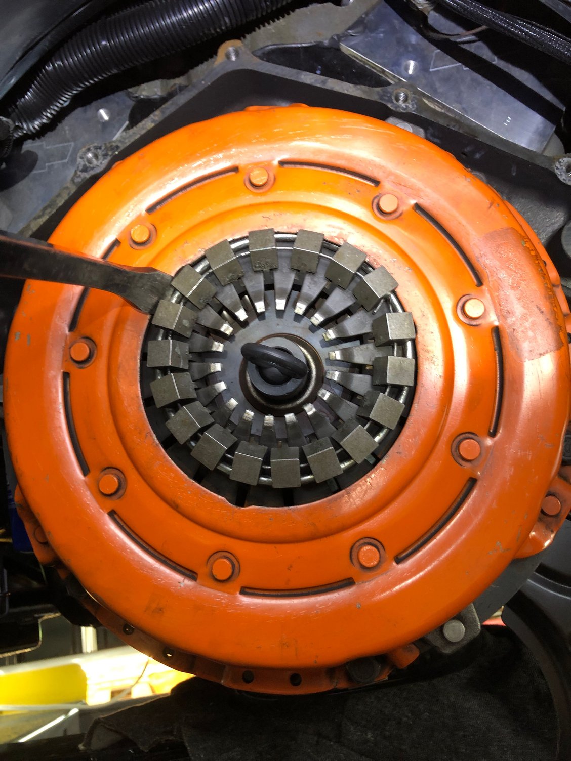

Got a complete kit from McLeod #75225 which includes throw out bearing.
I think the CF pressure plate was the problem. The ring was off centre again squeezed between fingers and cover. I could see the whole thing vibrating through the clutch fork hole. The Hays bearing was completely loose from the vibration.
I believe as the clutch wore out, the gap between the fingers and cover got smaller getting the ring caught in it. But, I also noticed the weight marks were uneven as if the ring was never centred properly.
one thing for sure, I’m done with this type of pressure plate. Weights = one more thing to go wrong.
Just a theory for now. I’ll have everything on the road soon and we’ll see
Heres some pictures:
Ring stuck
Pry bar to unstuck
Weight marks show an off centre wear pattern
New McLeod, 550ft/lbs capacity. Pedal feels good.

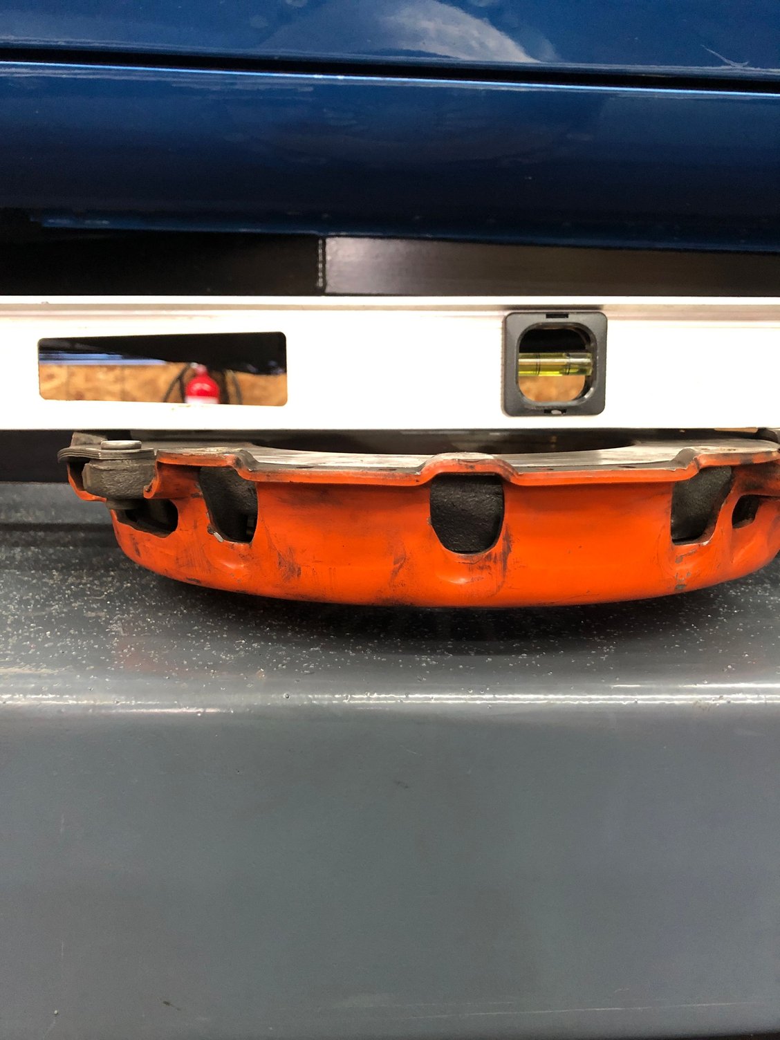

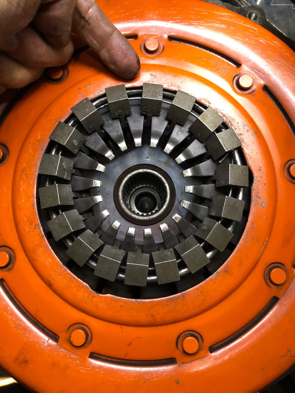

Some more pictures
The fingers on the CF are bent in a pattern that is consistent with where the weight circle was shifted off centre.
I made sure the surface was level before using the level. Honestly, it was visible without the level.
The poor bearing must have being wobbling like crazy

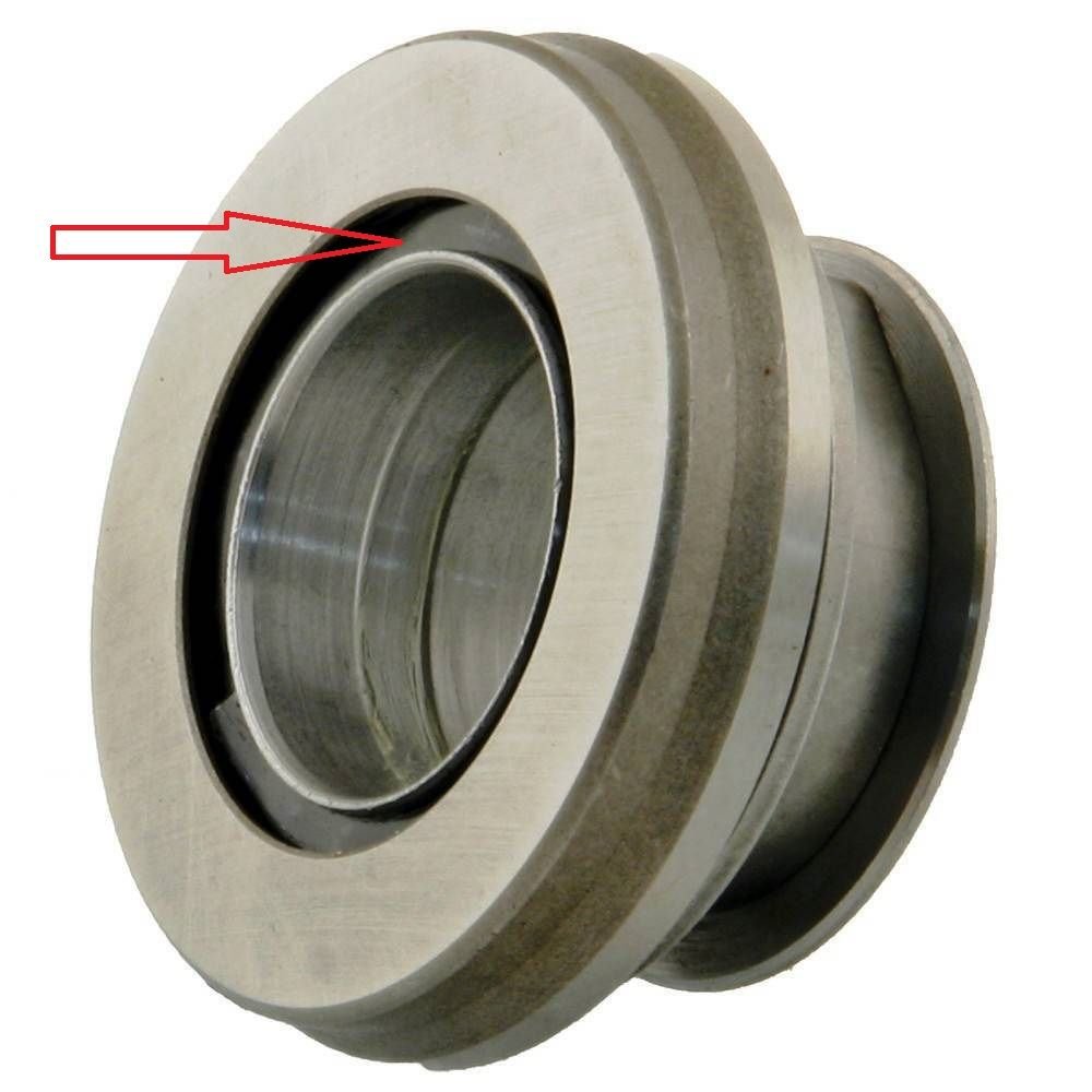

The bearing can't really "wobble". It's constrained by the clutch gear bearing retainer, aka the thing that sticks out of the front of the transmission around the clutch gear ("input shaft" to non-manual-trans people). The TOB fits fairly tight to that.
Now, if the CGBR is worn where the TOB slides along it, then the bearing COULD wobble; which is why that part should always be inspected carefully and replaced if it has wear that can be felt. In this photo for example you can see the shiny spot of wear on the 2nd design (bottom) one, although this one isn't bad enough to need replacement. They can get ALOT worse.
Also, when you bolt up the clutch to the flywheel with a disc in between, those fingers move. ALOT. After all, they are the opposite end of the spring that grabs the disc, which is basically a giant Belleville washer with its inner diameter split up into those "fingers". Without being installed, they may or may not be level, even, or anything else, all of which might change when the spring (fingers) is compressed.
All good info thanks.
The CGBR is fine in my case. The outer part of the TOB will wobble (observed with my peepers through the clutch fork hole). The inner part stays quite stable but the outer part follows the clutch fingers. That is what destroys the TOB, it gets a lot of play. I should have checked the fingers when it was installed. But from what I observed, there is no doubt that's what was causing the problem. The McLeod's fingers were quite level. The TOB and clutch fork don't vibrate (wobble) anymore.
