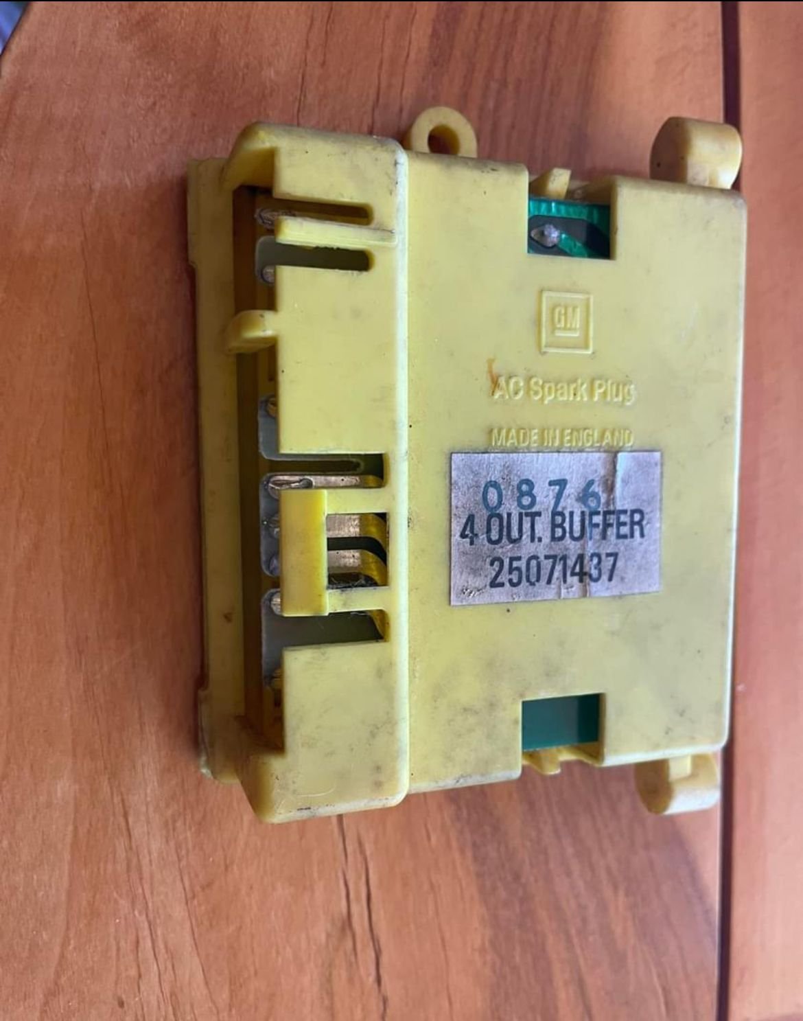

I think in 89 it was on the transmission tail housing. Do you have a Vss buffer next to the ecm like this ?
I’ll have to look. Thing is I only recall one plug on the 700, I’d though was for converter lock up, so will get eyes on it tomorrow when the rain stops.
