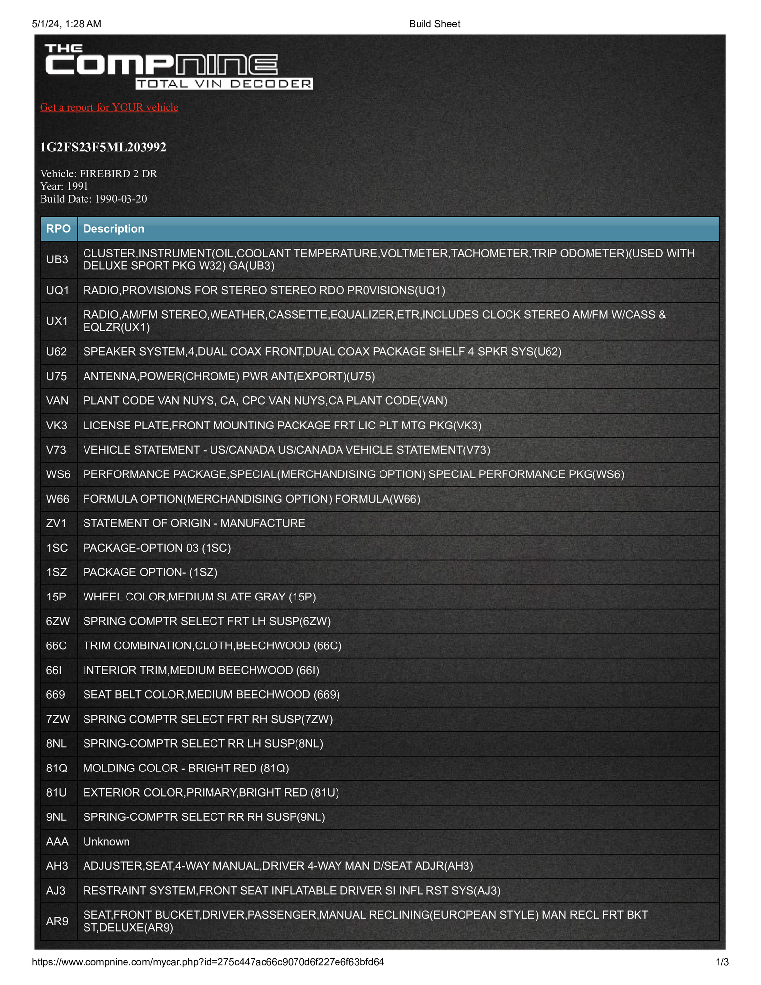

As for your missing SPID label that shows the car's RPO codes you can get a "Build Sheet" for your Camaro if CompNine has the info for your VIN on file. Enter your Camaro's VIN on the CompNine webpage and if they have the info it will tell you so. You can get the 5 CompNine "Build Sheets" for $5 deal if you want.
The CompNine "Build Sheet" will look like this.
CompNine "Build Sheet" for 1991 Firebird Formula
Some of the guys here can get your CompNine "Build Sheet" for you if you ask nicely. @JT and a few other guys with access to CompNine have done it for others here before.
