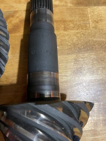

Just to eliminate any doubt, 9-Bolt.com is still active! I hesitantly ordered a 3.45 ring and pinion gear set from them via Paypal on their website and it actually showed up today! No other comms other than shipping confirmation. I now have two spare 9-bolts, both with Delco Moraine brakes, a set of 3.45 gears, a set of 3.27 gears, and two sets of 2.77 gears. One 9-bolt has the smaller pinion bearing and came with the 2.77 gear set. Both disassembled now, but I'm definitely going to rebuild the "common" pinion bearing rear with the 3.45 gears.
The 2.77 gears are available if there's any interest - LMK. I think I'll keep the two spare 9-bolts for future projects...LOL!
