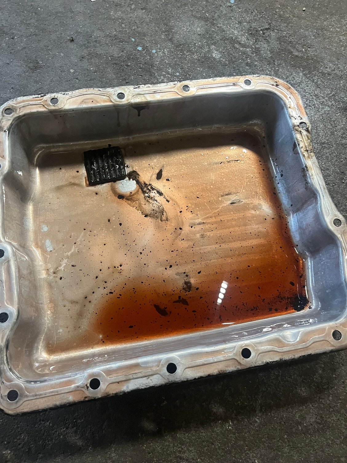

this is what I found in the pan last night, those black particles were almost like hard plastic and they were very chalky, I’m assuming that’s not good lol, probably friction material. I think my torque converter is failing to some degree as well because for a stock stall it feels way too loose and it locks up very slowly. Maybe I’ll have a shop look at it and see if a rebuild is imminent.

That's pretty chunky looking debris. Difficult to assess from this side of the keyboard however, while you may be able to put it back into service, any signs of slippage put you a path for a rebuild.
Is the filter also full of this stuff?
Remember too that any rebuild will mean a new converter. Or at the very least, cutting open the one you have for a thorough cleaning and an examination of the TC clutch. Don't forget to blow out the lines and (if equipped) the cooler as well.

The filter surprisingly looked clean minus two or three of those tiny little particles which is very weird to me. No gears are slipping at the moment and the shift changes are very quick, hopefully it remains that way. If I’m in 4th and I bypass the vacuum switch so it stays locked no matter what throttle input I do notice the RPMs rising if I get into the throttle but I’m pretty sure that’s just the torque converter clutch slipping which leads me to think converter needs replaced, if I disable the lockup entirely and get into the throttle in 4th it loads the way it’s supposed to with no slip.

Remember that the TCC in these OEM converters aren't designed for much more than cruising in O.D.. That's where, as you obviously know, the vacuum switch comes in. I had, at one time, incorporated an adjustable switch so I could change the set point but ultimately I went back to the OEM version as it seemed to work the best. Something I may revisit seeing as I've got a new powertrain and the engine, transmission and converter characteristics are very different from the previous iteration.
I've wired in an option where I can have lock-up in third but even though I've an aftermarket converter, it's still a single disc and hasn't got the higher holding capacity of the triple disc option that, in retrospect, I should have gone for. I'm not entirely certain how some people will chassis dyno their 4L60 equipped cars with the lockup in third. I'd be afraid of shredding mine.

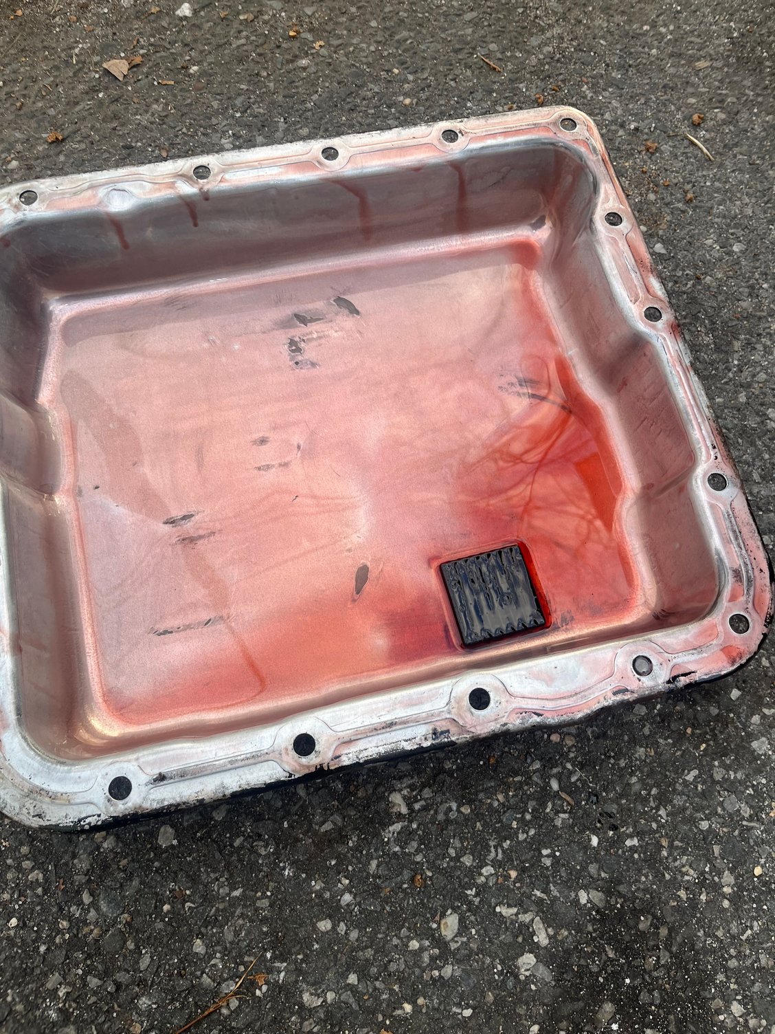

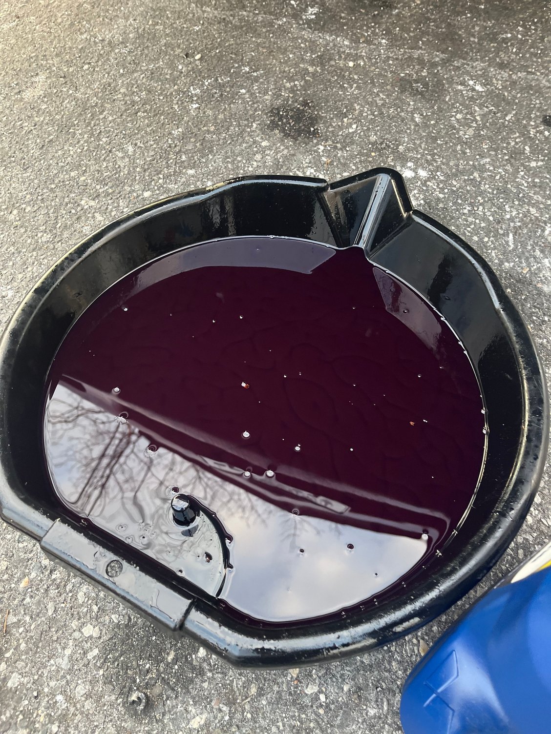

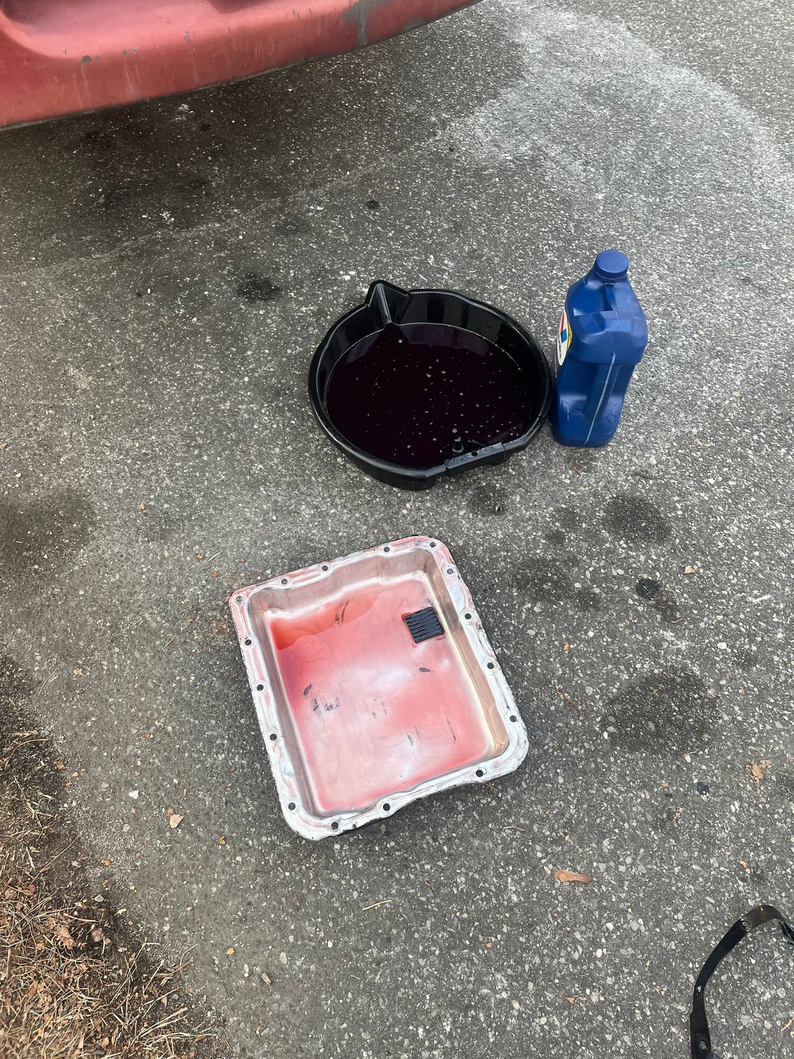

Old Feb 18, 2025 | 04:21 PM
leakyz28's Avatar
Joined: May 2022
Posts: 95
Likes: 14
From: Long Island
Car: 88 IROC-Z
Engine: 350 H.O. w/ 113 heads (SUM-8800)
Transmission: 700r4 stage 2 500hp
Axle/Gears: 2.73 Posi Yawn Fest
Re: 700r4 part throttle 4-3 downshift
welp, rebuild is imminent. 3rd gear WOT pulls result in a slight slip, RPM's start to run away them come back, then start to run away again. Give it up for 80,000 miles on a stock build, gotta love a 700
also found a 3.27 9 bolt rear with disc brakes for cheap that's going in.
