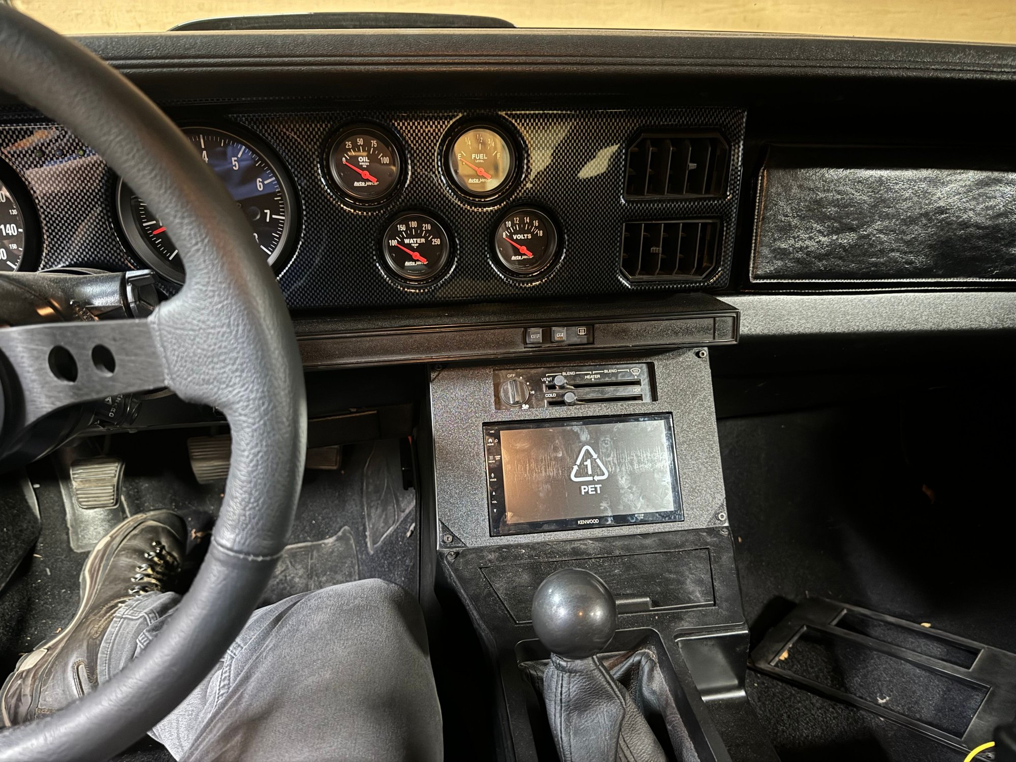

I used a short shifter from tick. I also used the upgraded shifter bushing. I don't know if I needed all that or not. I never drove it w the stock Tremac stuff. All I know is it shifts awesome. The magnum f is perfect in these cars. The shift gate is almost too tight, but it's really all just perfect. The actual stick that came w the tick shifter is like 5(ish) inches and perfect. I used a three pedals adapter plate to move the shifter stick 1.5 inches forward. This was more for personal preference/where my seat/arm were in relation to the shifter. There's a website where I got my shift **** called "twisted shifters". If you can't find something there I'd be surprised.
this is first gear
