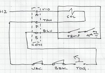

FWIW: My 84 carbureted Camaro was non-computerized. TCC lockup was factory designed to work via the brake switch, vacuum switch and the 4th gear applied switch (in the transmission).
By way of comparison, the 82 Monte Carlo in the "fleet" was done the same way.
I've duplicated that in the current hot rodded 82/86 chassis.

I perused the wiring diagrams for a vin H '86 and they show a NC switch going to the TCC and a NO switch for the stops. The NC switch had two outputs, the second looks to have gone to the cruise.

Crudely drawn, I've copied the OEM and wired mine this way. For testing and better utilization, I've added a toggle disconnect to open the circuit.
