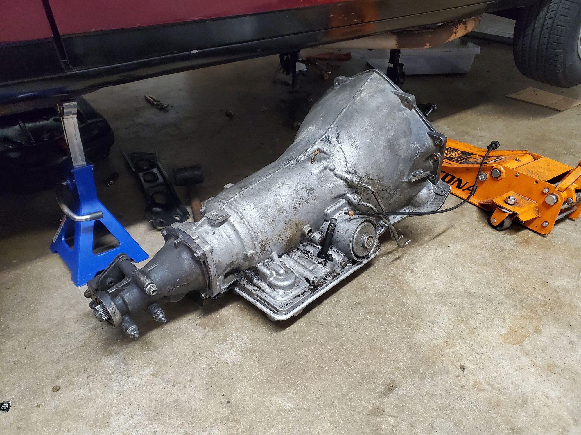

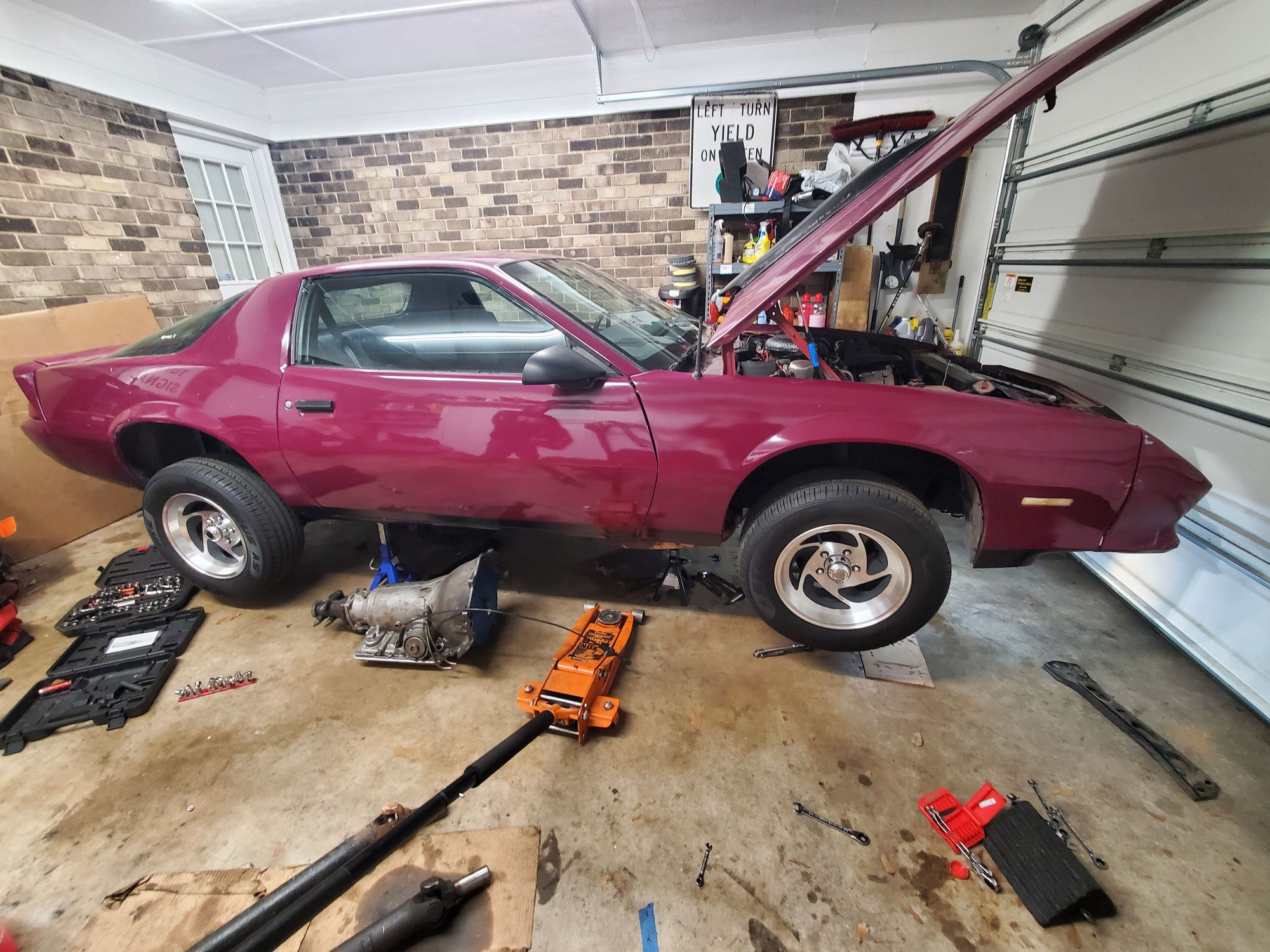

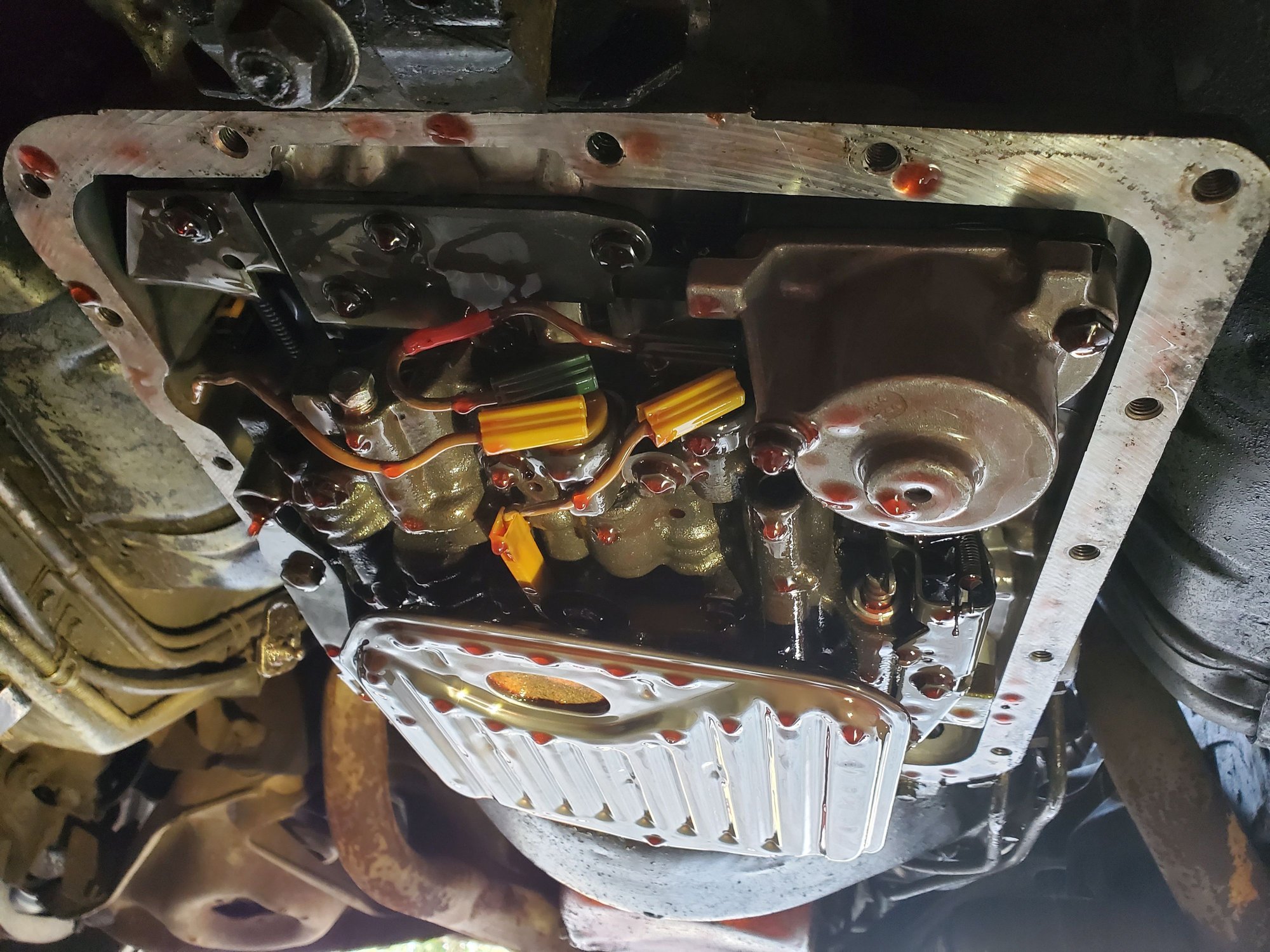

First step was obviously pulling the transmission. Backed the car into the garage, placed it on jack stands, and got to work. I dropped the trans pan, drained the fluid, and took a few pics. Apparently my "freshly rebuilt" 700r4 had been obviously gone through. There was a butt splice on one of the wires in the pan. This 700r4 never worked correctly, always overheated, and lost 4th gear after a short drive.
I then removed the driveshaft & torque arm, removed the inspection cover, unbolted the torque converter bolts, and removed the TV Cable from the Carburetor. I took a break to eat dinner with some friends and came back later that night to remove the transmission itself. It was only secured by the bottom four bolts in the bellhousing, no bolts in the two upper locations. For some reason, the crossmember was notched about a half inch back to accommodate the lower mounting point on this transmission. I speculate that the drivetrain in this chassis came straight from a squarebody silverado, and just dumped in here. No changes made, except for notching the crossmember to make the transmission fit. Furthermore, the transmission cooler lines were JB welded to the transmission, so I had to cut them off with a sawzall. Fantastic. Anyways.
The transmission was out by 9pm the same night I started the swap. Time to do the actual work.
Transmission immediately post removal

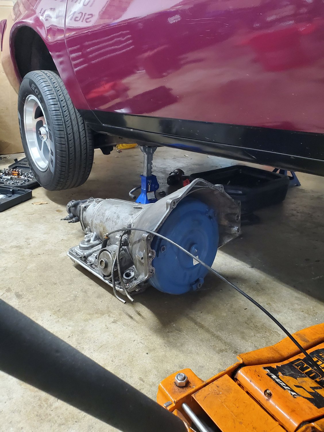

New torque converter with a build date of Jan 2023. It was never right.
Notice the color difference between the tailshaft housing and transmission, as if this transmission wasnt originally meant for a Camaro.
Notice the color difference between the tailshaft housing and transmission, as if this transmission wasn't originally meant for a Camaro.
I also found out with this transmission removal as to why I was puking transmission fluid every time the vehicle would reach operating temperature. The TV cable was broken at the transmission side, allowing the pressurized fluid to just leak out. In the moment, I was glad that I was rid of this terrible 700r4 for good. Honestly though? I still am.
