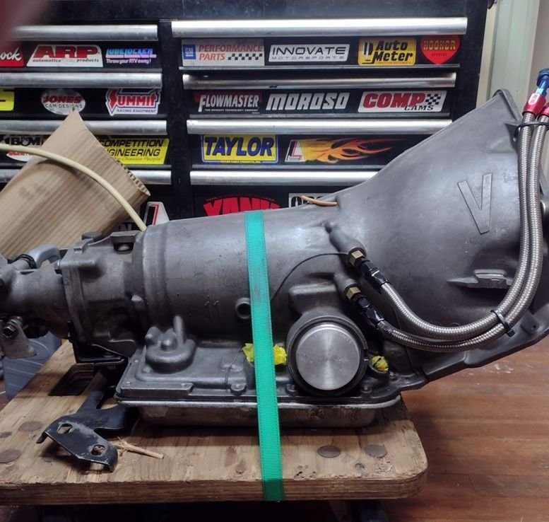

Why not AN lines to get onto the frame in the engine compartment and then whatever you want from there to the cooler?
Prototype with rubber hose and clamps. Crude but effective.
Hard lines to the cooler.
AN lines adapted to the 4L60.
The flex lines swing up onto the passenger side frame rail. I did this more because I was doing a LOT of transmission and converter swaps and this made getting to the cooler line fittings far easier.
I never did like the OEM route alongside the engine.

Thank You for the pictures
