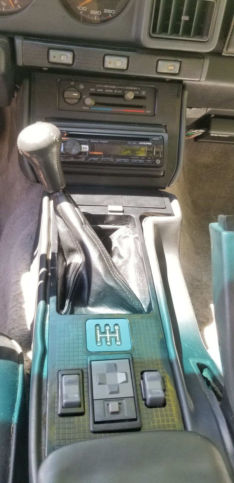

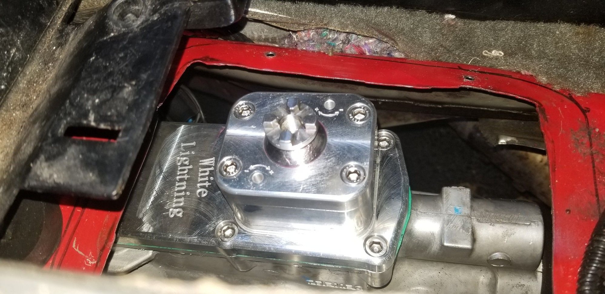

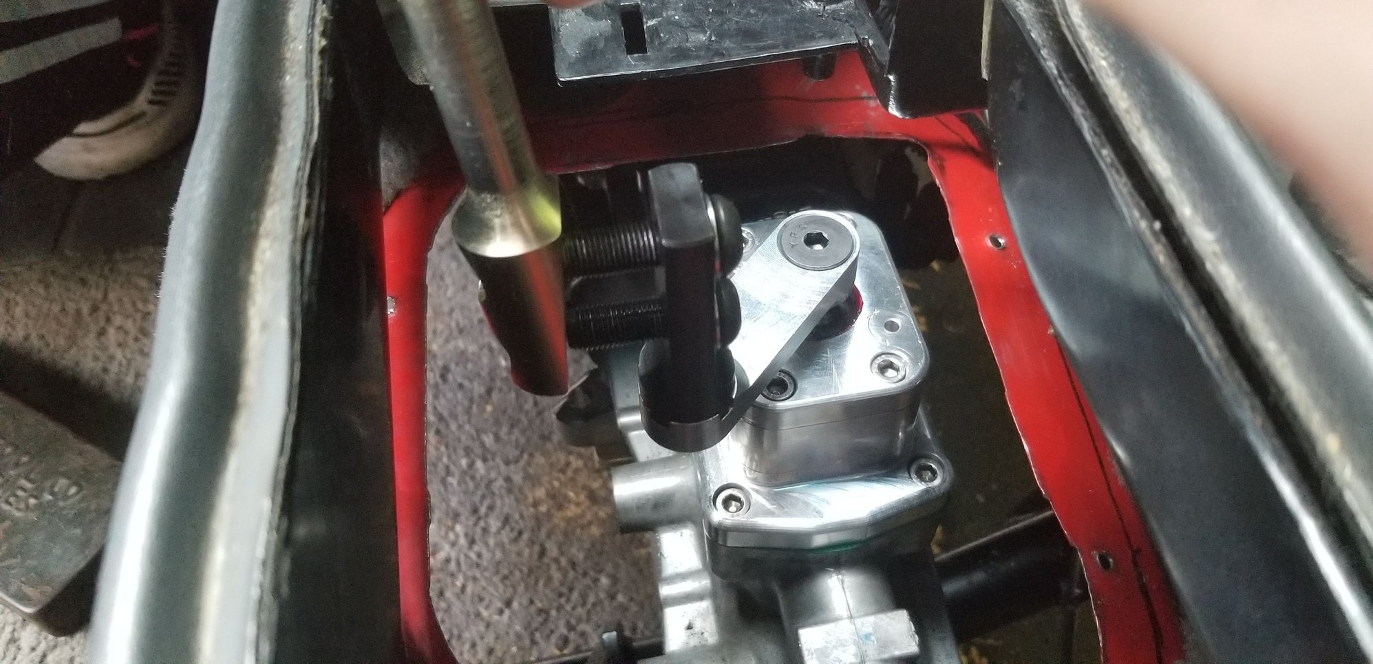

And after finishing the swap, realized that I also needed:
-An offset shifter (I chose an American Powertrain White Lightning, because I'd already gone this far, so might as well); Called APT, you will need a 2.25" offset for the TKX in a thirdgen for it to sit right! I can now confirm that the 2.25" offset fits perfectly with the 86-92 console top plate. They also recommend a 10deg angled shift handle, which leads to the last item
-A Pro 5.0 GM T5 shifter handle (I used the stock TKX shifter and a Sikky 2" layback shifter arm at first, which worked, but wouldn't clear the ashtray with the console plate installed). Obviously, you can go with whatever height you want, but I found that a little over 7" is perfect for me to rest my arm on the console lid and hold the shift **** comfortably. This handle also has an 11deg angle on the mounting face, which worked out perfectly. You WILL need to enlarge the bolt holes on this handle though, since it turns out that Pro 5.0 uses smaller bolts on their shifter, but this wasn't a huge deal.

Last edited by LLCooLM495; May 4, 2026 at 07:09 AM. Reason: Shifter was finally swapped out, updated info for that section

New shifter in!  It was easy to install since it uses recessed allen head bolts, though they dont give you a wrench.  Had to dig out the trusty ziploc full of allen keys
New shifter in! It was easy to install since it uses recessed allen head bolts, though they don't give you a wrench. Had to dig out the trusty ziploc full of allen keys
Another view.  You can see the two holes for adjusting the spring bias, though it comes set to
Another view. You can see the two holes for adjusting the spring bias, though it comes set to "full aggressive" right out of the box
Offset arm mounted, Pro 5.0 handle doesnt quite fit!
Offset arm mounted, Pro 5.0 handle doesn't quite fit!
Tried to get a view of the holes on the old shift handle vs the Pro 5.0; not much smaller, but small enough to need drilling.  Bottom hole was drilled out one size up, top hole was 2 sizes up to account for the angle of the mounting face.
All installed!  Need bezels for two of those switches, but everything fits great!  Transmission is in 1st in this pic, definitely close to the console plate, but does not come into contact
Also, got an update to my thoughts on this shifter after driving home: this shifter is INSANELY smooth! The 2-3 shift is unreasonably quick, I'm a big fan combined with the relatively short travel I ended up with on my clutch pedal, shifting feels almost instantaneous now. I thought I might have needed to adjust my clutch a little bit more when I still had the stock shifter, since it'd fight me a little sometimes on 2nd and 4th gear, but it's completely effortless now with the APT. If you're going to swap a TKX into your car, I highly recommend you give this shifter a go! Yeah it's another $450 (with shipping/ tax) on top of the cost of everything else, but I dare say, it's worth it. The stock shifter is still totally fine, but this made a brand new transmission feel... even newer, somehow. Really not sure how to put it into words, but this shifter means business. I'm sure other TKX short throws out there are pretty dang good too though, so do your own research and see which one is right for you!
