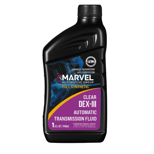

Re: Overfilling question
you really should stick to the red kind instead.

@GearheadSS I can't read because the oil is 1. almost completely see-through and 2. smeared all over the dipstick when pulling it in & out.
Yeah, I should probably move to a different oil. The stuff I used this time has very little color in it.
