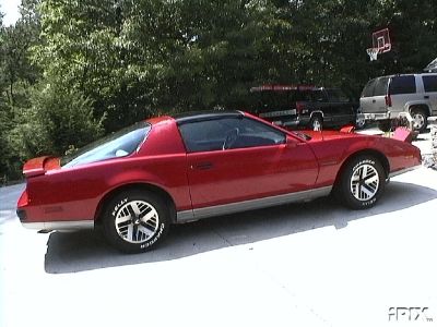

Thanks 89V6 & TomP.
As for the headlight issue, yes I would like to see the thread on replacing the bearings if thats what is req'd. I have not seen these work in action correctly, maybe I should find a local 3rd Gen Bird owner to see how. The motors spin the manual raise ***** at a pretty good speed, but do not make what I consider excessive "whirrring" sound? I'll search the threads as suggested.
This is really one fun car to drive.
We average 27+ mpg through the mountains of North Carlonis and East Tennessee. We actually got 30.2 the rest of the way. Not bad for a tame sports car, huh?

AA88Fbird, you got a nice lookin 'bird there. Keep it shining, what color red is that?

My son refers to it as "ARREST-ME-RED"!
