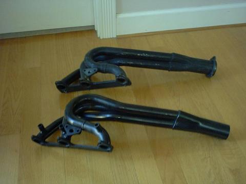

No those won't work. The center primary hooks to the head more right of center and those are left of center (Democratic headers - I crack my self up) Heres a pic of 60*V6 Camaro headers from Hooker & Heddman. (Hookers are in the front of the pic)

I don't know what else to tell you- I discribed why they are different and even posted a picture of my two sets that will work on 60*v6 F-bodies 82-92 automatics for comparison. If you study the picture you will clearly see that the offset of the center tube of the three tubes that bolt to the motor is to the wrong side- They will not work, those are designed for a different motor- quite possibly a 90*V6 which is not interchangable.

Here's a pic of the left side Hedmann for better comparison of the center primary offset.

They won't fit. Period. Do your research. The monte carlo came with a 4.3l ***90*** degree V6
