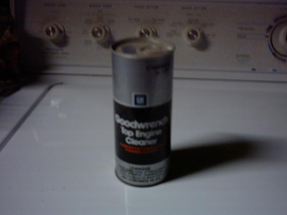

GM top engine cleaner- buy a can, read the directions
