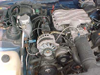

The kit is a NOS brand one, and it is for a 1986-95 5.0 liter Mustang. It is a dry flow system, which means that it sprays the nitrous into the front of the engine, but puts the extra fuel through the engine's fuel injectors instead of dumping it into the intake. Mine is an adjustable kit from 50 to 150 HP, and I set it for 75 HP gain. They have a kit advertised in Summit for the Mustang that is non-adjustable and is rated at 75 HP gain. It sells for about $460, and I think that it would work great with our 3.1 liter or 2.8 liter fuel injected engines.
I did the installation myself. The hardest part was drilling and tapping a 1/8-27 NTP thread into the throttle body in front of the throttle plate. The wiring wasn't too bad, and running the lines wasn't too bad. Other than the drilling and tapping, if you can install a car stereo amp and can change a sink fixture yourself, you should be able to handle it. Mine also has a micro switch so that it doesn't activate until you both arm it, and floor it. That is the way it should be, but if you get a kit that doesn't have a throttle activated switch, it wouldn't be too hard to get one and rig it in there.

YOU HAVE A SMOG PUMP!!!

Yes, and I believe that all 1992 Firebird V6 cars had them. I have done nothing to the engine other than add the nitrous, and it has been totally reliable.

Hey guys... I have been out of town for the past week, so I haven't been able to check my e-mail.
I have never had my car on a track. I plan on changing that this summer, but I have never really cared about track racing, just wanted more power on the street.
I will say this, I can beat a stock 5.0 liter 5 speed Mustang. I said Stock, so no flaming me! I know this because I have done it more than once. It is pretty close, though. If they have put catback exhaust and power pulleys on there, then they will beat me. I can tear up a convertible mustang, or a stock Impala SS, and I am talking about the mid 90's ones that were RWD. Stock 305 camaros and firebirds I can beat, especially the TBI cars. They are really easy. Anything any faster than a stock Mustang 5.0 will get me, but oh well, it is only a 3.1 liter engine, and other than a catback, high flow cat, and the nitrous, the engine is stock. I don't even have an aftermarket air filter.
Of course, when the bottle is empty, then the fun is over.
i've noticed that alot of people on here have taken out their smog pumps....are they really that restrictive? since we dont have any emmisions testing at all in georgia (ahhh, it's nice), should i take mine out? if so could you give me brief instrucions on it? i don't think i've ever even touched my smog pump before, let alone think about messing with it, but if it's worthwhile let me know.
i've noticed that alot of people on here have taken out their smog pumps....are they really that restrictive? since we dont have any emmisions testing at all in georgia (ahhh, it's nice), should i take mine out? if so could you give me brief instrucions on it? i don't think my finger has ever touched my smog pump before, let alone think about messing with it, but if it's worthwhile let me know.

They're basically extra weight that takes up some HP from the drivebelts. Plenty of f-bodies came from the factory without them (like mine), and still pass emissions.
