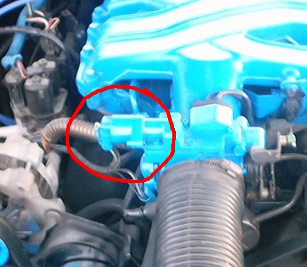

Turning to crank and not getting diddly crap is your VATs system tripping. Mine did it all the time. Lemme guess...5 mins later it'll start no problems, but if you try a few times after the no-start without waiting long enough, you get nothing right?
Stalling is a separate problem. I'd bet money that it's one of two things.
1) IAC valve sticking/acting up. Remove the sucker and clean it...if it's too bad or nothing changes, and you've tried #2 on here, replace it.
2) Fuel filter. Could be fuel starvation. Mine used to stall when I was slowing down for stop signs and such..basically, when the rpms went down too quick..it clogged and couldn't get fuel.
Both of these are cheap and easy.....well, the fuel filter might ba a tad tricky..
About the oil...no biggie. 1/2 quart is nothing. Engine won't know the difference. Shops typically overfill engines by 1/2 quart actually...if you ever have an oil change somewhere (which I dont advise......) you'll notice almost every time that there's 1/2 quart or so too much in it when they're done. Most that'll happen is maybe a psi or two of extra oil pressure. Whoopty doo.

Umm...whats an IAC valve, and I went to the local autozone today, and guess what..no fuel filters..got try again later i guess.
Old May 17, 2003 | 09:36 AM
Nixon1's Avatar
Posts: 3,931
From: Palm Bay, Florida, USA
Car: 95 E-150 & 07 Kawasaki ZX-6R
Engine: A slow one & a fast one
Transmission: A bad one & a good one
Axle/Gears: A weak one & a chained one
This is a photo of a 3.1 engine..on a 2.8 the IAC valve is in the same location but it sticks out of the back instead of the side. IAC stands for Idle Air Control. The computer opens and closes the IAC valve depending on throttle/driving conditions, such as cruise, acceleration, deceleration, etc. The IAC gets covered in carbon and gunk after a while, which gets onto the valve and spring, and slows its ability to open and close quickly. When the valve can't open and close as quick as the car needs it to, this generally results in stalling, or almost-stalls. Easiest solution is to remove it and clean it thoroughly with some throttle body cleaner...just avoid accidentally releasing the 'pintle' that is held down by the spring. The tension on that sucker is so high that if you do, that thing will enter orbit never to be seen again. Make sure the o-ring is intact when you replace it. The 3.1, you have to remove 2 Torx screws to get to it. The 2.8 shouldn't be too much different.
