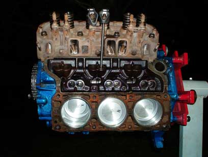

Yes Tom, you read O.K.: 242 !!! PSI. I did the tests and I saw the compression tester and the flat 0.020 pistons with my own eyes!!! (the same compression tester read 155 in a 2.8 Corsica with 100.000 miles no rebuilt. I think with original dished piston).
I used FELPRO head gaskets without sealant.
I've repeat the test a lot of times: max reading was 248 in one cylinder. (engine cold at normal environment temperature).

the way that i have about 10.75:1 compression is... I was building a new motor and was going to use flat top pistons. we went to put the rods and pistons in the motor and noticed that we had about .100" pop up. we knew that would not work so, we did some custom work. we did alot of measuring on the pistons and decided we would put the pistons in the lathe and cut a ring off the outter edge of the pistons (to clear the heads). so, we ended up with, in a sense, domed pistons. the block is also bored +.030". here's a picture...
