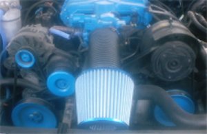

You have a 3.1..which means... Check the flex tubing coming directly off your throttle body. You know the black, ribbed, flexible rubber piece? Look on the passenger side of it..it's got a hole and a fitting in there. The elbowed plastic piece sleeves into the flex intake tube, and then goes into the valve cover with a special fitting. This is the PCV return tube...not the actual PCV valve. The PCV valve is on the DRIVER'S side, as zoomzoom mentioned.
You can barely see it here...but it's on the left side of the photo....
And by the way...don't use this intake setup. This is a photo of an old experiment of mine. Worked great. Til the car got warm.
