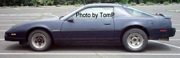

The "BEFORE" shot!
Here's the before picture!
Attached Thumbnails Suspension Rebuild DONE!!  Latest status &amp; results &amp; etc!-imag0001-small35.jpg

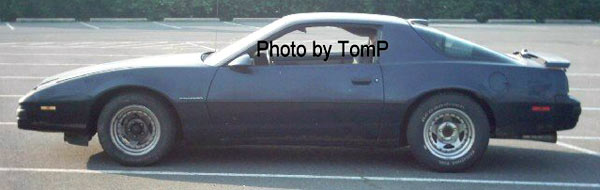

Here's the AFTER shot!
Here's the after picture! Final combination was Suspension Techniques V6 lowering springs, KYB GR-2 front struts, KYB gas-a-just rear shocks, KYB strut mounts, Energy Suspension bushings in lower control arms, Moog ball joints, and all steering linkage uses new Moog parts.
Attached Thumbnails Suspension Rebuild DONE!!  Latest status &amp; results &amp; etc!-imag0048-small35.jpg

Aw damn, shoulda thought of doing this picture in the first place! Makes it easier to see a change (can fit both on the screen at once)...
Oh and did I mention absolutely, positively NO squeaks??

Thanks!!! See what I mean about how low the rear is? Yikes... Now the car just needs a bath... or, I should at Least clean the tires or something.

Yeah... looks almost like you couldn't trimmed a very slight amount from the front springs - but hey, maybe they'll come down, as the springs settle in!

Xcelerate, honestly, I don't like the looks of 16 inch wheels. All the tires are new (P225/60r15 front, P245/60r15 rear), so the most I'd do is buy my same wheels in aluminum; right now they're steel (heavy).

Here's those images a little larger than the 2nd group of photos, but smaller than the first batch.
They've been resized and cropped in Photoshop.

hey TomP, how do you like those springs? did u get them from ebay? I decided to use Sprint springs (which i got on ebay) because a friend of mine has them. How harsh is your ride? I have the same shock/strut setup as you, and it feels almost like i have blocks inplace of my springs when i go over speed bumps.
oh, and i like the stance after u put all the crap in... how many fingers is your wheelgap? mine still needs to settle in the front (3 finger in the front and 2 finger in the back)
here's the only pic i have of my new stance... made my dad give a thumbs up lol.
