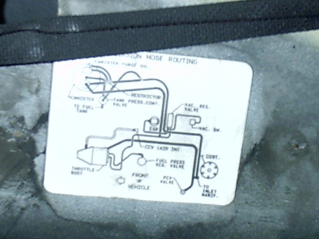

Thanx for the diagram karl, had actually been wanting to get one of those for quite some tiem, and finding one for an 85 seemed to be a little fete'
