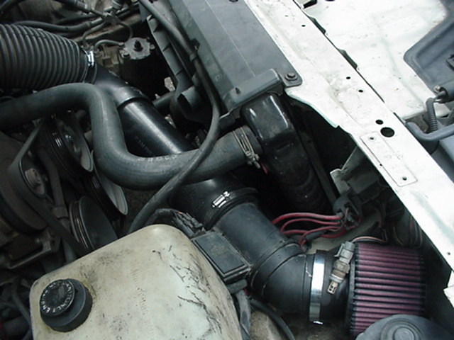

ok, so i decided to make a cold air intake on my firebird since i was tired of getting all my air through a hole that was 6"X1". thats crap, so i followed the link on this site to a tech artical for CAI for firebirds. it can be seen HERE . well i went down to the home depot and auto zone, had to order the filter, once i got it a couple days later the complete install took like an hour or two. anyway, i hosted some pics on cardomain. its acting real funny so i hope the links work.
first, the stock intake we all know and love.
and now the new one
also, there was a senser in the side of the metal air box that goes around the filter, i dont know what it does, so i left it plugged in and zip tied it to the body where the old intake met the nose. it can be seen below. if anyone knows what this is please tell me.
and one more thing, my charcole can. will removing this cause any problems. and if i do remove it, where do i put that senser that plugs into it. and what do i do with the fuel vent line? could i run it to the intake so the fuel vapor gets burned in the engine? that would be kind of neat? anyway, here is a pic of the canister
and finaly the results. well in adition to making a baddass hissing sound, that is AUDABLE outside the car, it actually whistles as you hit 2k. sounds like i have a little turbo on there. i have not noticed any increase in performance, but my encine runs at like 180* instead of 220* cool huh (pun intended)
if anyone has any questions about what it took, or how much or anything feel free to PM me orpost them here.

Nice job! That sensor's the MAT, manifold air temp sensor. As long as you hang it somewhere near the filter, you'll be okay... this sensor has to see the temp of the incoming air. So it wouldn't be good to hang the sensor over the exhaust!

Id stick the air temp sensor back into the piping. say half way up. faster air is colder so you want the computer to read that and ajudst for the colder air.

well this is a bit of a necro post, but just to clarify, i zip tied it to the unibody just above the filter. i don't know if you can see it verry well, in this picture it is on the FAR right of the photo almost off the frame.
EDIT upon reading this on 01-25-06 i discovered that the picture i linked too DOES NOT SHOW what i was talking about here. but i'm not going to change it you'le just have to use your imaginations

Xophertony, how did you support that 9" of tubing, it looks like its just sitting there. I was thinking of taking the hanger that supports the box on the stock setup and just bending it down to hold the new tubing, not sure if its gonna work tho.

BINGO. i bent it a little and secured the pipe to it with zip ties.
for a while i just had it hanging there (as pictured from last may) i do not have a picture with the zip ties. i'll try to get one to put up. also i would recomend using a bigger filter then i did.
good luck.
EDIT* detailed engine bay. new pic!

How is this setup better than stock? Your airflow is still obstructed in this area. Would be interesting to see what little power if any you have gained from this.

I went with just about the same setup. I didn't get much of a cool intake sound, but I noticed a decent increase in power.
I actually cut the curved part off the MAF, and attached the filter directly to it. (left the screen in too, as it straightens the airflow I guess)
Then I just rigged a gradual bend after the MAF.
I also disconnected the battery while I changed it all, so when I started and drove it, the computer was starting out fresh while mapping the air intake stuff, instead of adjusting from it's previous airflow readings.
I remember reading that was the way to go anyway.

Xopher, your CAI looks almost exactly like mine. I think my K&N is from a mitsubishi something or other and I was able to get it off the shelf at Advance Auto Parts.
I use a 3" 90 degree bent PVC elbow coming from the original rubber flexy hose thingy, then a rubber spacer, the original MAF, another spacer, then I popped a hole in the second spacer and inserted the MAT sensor. another 3" PVC pipe, then the K&N. Its angled just about perfectly in the area where I removed the original air filter can. I don't have any clearance issues with the canister, they coexist just fine.
I have had mine for about 3 years, and I'm quite used to the audible hissing sound and the "whizzing" sound that seems to happen above 2500.
Every single person who knows anything about cars thinks I have this huge vacuum leak until they look under the hood and find the sound coming from the intake.
