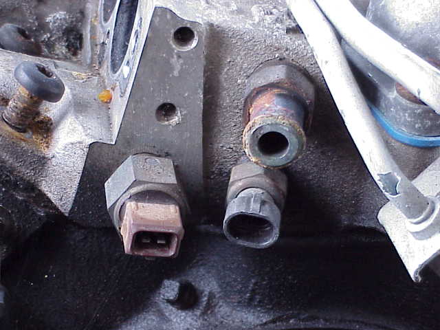

Old Jun 25, 2004 | 10:44 PM
Trickster's Avatar
Posts: 6,127
Likes: 11
From: conway, s.c.
Car: 1989 Iroc-Z
Engine: 5.7L TPI
I mean check the connector, the wiring, and pull the switch and look at it to determine its condition. Here is a picture of it. It is the unit with the pink top, the other unit there is the coolant temp sensor (CTS).

I looked at it and it all seems fine with no problems. Nice and clean. If it was leaky injectors would it give me problems weather warm or cold? Thanks for all the help
