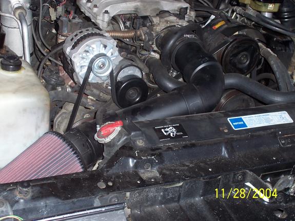

My car will shut off while I am rolling at 10 mph or less in traffic, she kinds off lets you know by shuttering a little bit (sometimes); so what I do is; if I have enough room to move in the slow traffic, I will give her a little gas, I kind of have to play a timing game with her when stuck in traffic; I let a little space get between me and the car in front(hopefully no one jumps in front of me) and then I put my foot on the gas to keep her moving a little bit. she does not overheat. She has no problem restarting.
Oh, BTW - she has no problems while waiting for lights to change; it seems as though it happens while driving on the highway/high speeds the having to stop and slow down for a traffic jam.
Here is info on car: '90 Firebird V6 3.1 bought in 10/04. Wires, plugs and cap, pulley were done just prior to buying her (not the top of the line wires or plugs). other that that I did a complete tune up.
It has a custom CAI (see photo).
My guess: IAC, MAF or ECM or maybe fuel sensor or regulator issue.it seems as though it happens while driving on the highway/high speeds the having to stop and slow down for a traffic jam.

Do you have your IAT going into your CAI? I put mine in my intake at the same time you may want to look into that as well.
Old Dec 15, 2004 | 06:23 PM
TAMAY's Avatar
Joined: Sep 2004
Posts: 79
From: Manhattan, NYC
Car: 1990 Firebird V6
Engine: 3.1L
Thanks guys:lala:
here is a photo of how my CAI is setup.
I will check the hoses and I do have a can of sea form in the back of the car.
I will let you know how it goes this weekend when I have a chance to work on it.
