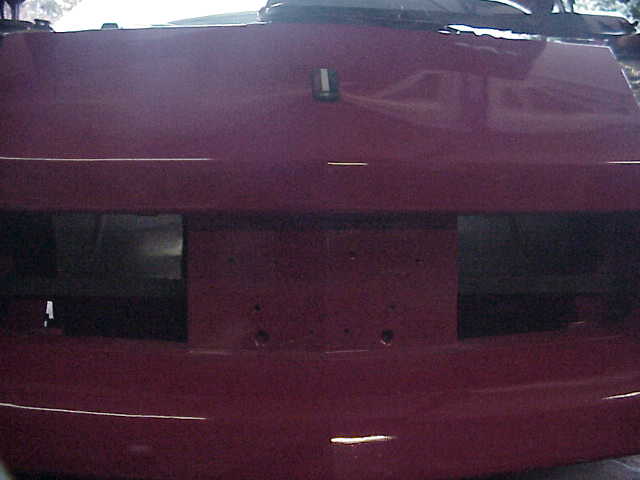

Remove the baffles, bolt on some ram air scoops that take air from behind where the fog lights would go, make sure u get the iroc front grille with the holes already there, much smoother flow for the air coming in the front. I have driven in a total downpoor for over a half hour and because i was so paranoid about the water getting in I checked the filters after I got back home, barely even moist, which would be normal for any filter on a wet day. You just have to make sure that there is a small gap on the back side of where the scoop bolts to the lower element so that any water that collects and is pushed up there at high speed flows up and over and out of the scoop. I have had mine for several months now and its has worked fine with no problems what so ever.
Even in dense fog I have had no problems at all, even heavy snow.

So here is my $25 CAI for my 88 Firebird 2.8 i custom fit it to go where the old filter box was. Now i have a weird issue.. it is throwing 32, 33, 34 codes and it is really confusing me.
I did put the MAF back in but why would it throw 33, and 34 codes? Kinda cancels itself out right or is the MAF bad?
Attached Thumbnails custom cold air intake for 2.8l camaro-20140428_125803.jpg   custom cold air intake for 2.8l camaro-cai.jpg

your still sucking in hot underhood air
would that be the reason for the codes? I do plan on extending it...just trying to find the best spot.

It looks like it is backwards. They only flow one direction.
Didn't even notice that that fixed it and i fixed the CAI Take a look i routed through and down into the pass side fender. splash guard ensures it will stay dry.

HAHA thats good that you fixed it now.

Very cool, haven't seen a CAI done like properly on a 3rd gen 88birdman, nice job!
