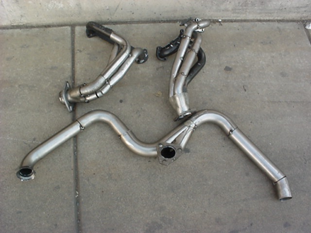

Below is the PaceSetter PREPRODUCTION Street Legal V6 FBody Header picture.

Whos pic is that??? your or PS???
Not very impressed by the pic. All I see are slip fit pipes with very few tack welds???

gumby, that was a picture sent to karl about 6 months ago showing progress of they had a car in, and test fitted some.
That is not what you get. Search on my user name, I posted some damn nice pictures of what you get.

I wouldn't be showin that pic as part of this thread then.
its not gonna help sell anything.
It should be removed with the right one in its place.

Hey, those pics don't look like they have the bungs for Air Injection in the diver side...please correct me if I'm wrong.
Yep, those are headers. thus no emission crap.
If that were true, then no headers would be legal in California...
They have an EGR mount...
I'm a Smog Tech here in California and have seen plenty of headers with AIR bungs.
If they don't have the AIR holes, then they are NOT LEGAL for ANY f-body in California with air injection (manual trannys mostly), even if the E.O. number says they are ok for that model year the car would fail for missing AIR injection and Modified "Other Emissions Equipment."

Well, Karl did note that "Below is the PaceSetter PREPRODUCTION Street Legal V6 FBody Header picture," but a up-to-date picture of the actual headers would be better than one of the prototype.

2_point8_boy:
The headers do not have connections for AIR, neither the 2.8L or 3.1L style.
