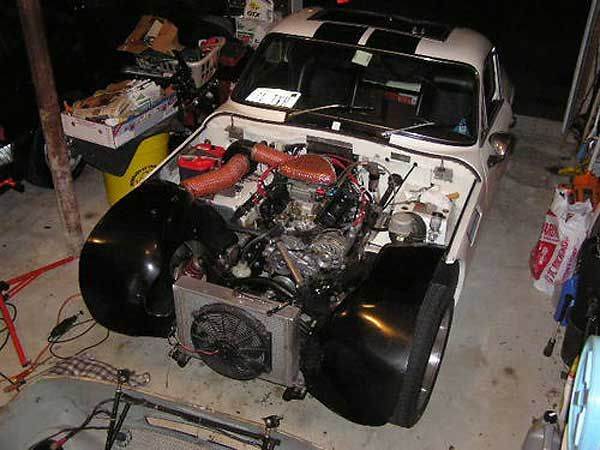

Hi All
I am new to the site, I am going to put the new Chevy 3.4L crate engine into my car, I am putting the Edelbrock Performer 4V manifold. 390 Holley carb. I am staying with the cam that come with the crate engine because it is just about the same as the Edelbrock's. I am going to have to get a distributor any suggestions. Any thoughts and suggestions on my whole set up.

into a 71 TVR
