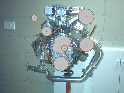

This is what I am debating doing to mine. My problem is "will the crank pulley slip?" without the 180* grip contact from the stock angle off the WP. I am going to an electric WP and am debating if I can get away without a dummy pulley in its place.
The next issue is "will the powersteering (P.S.) slip if I run the A/C belt on the hotter months?" I will ultimately someday just entirely remove the A/C all together- but that will be several years due to the fact I just put a brand new R134 system into the car 2 years ago for my wife- she drives it mainly for now. When I finally break down and buy here another car I will scrap the A/C but for now I will be installing the electric WP by next summer (Is my goal)
