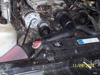

UPDATE:
just got the car back from the shop after replacing the Fuel pump and filter. Feels a little better, gas flow is good ; I have not had a chance to run it hard on the Highway to see how she does, I will give her a run this weekend. I am going to change the starter solenoid and if that does not solve the issue I will check the ICM.
It seems as though everyone on this site thinks it's the ICM so I will change both the starter solenoid and the ICM.
I bought the car back in September and have replaced the following:
Complete Tom's Tune-Up (Wires, Plugs, Cap, etc..)
Tranny and coolant flush.
Exhuast system to include the Cat Converter and Oxygen Sensor.
Front Suspension.
New belts, pulley.
Front Suspension.
New belts, pulley.

HERE IS THE UPDATE:
WIRING SEEMS TO BE THE ISSUE
Last Night; I took it for a test run while going to pick up a new ICM, well let me tell you it was not the ICM causing the shut down. It shut down again and I was stuck on the road until late
I was really ready to junk the car, but the body is great and when it does run it is a real Stallion on the road, so I am
I did notice the wiring for the coil was a little stripped. ( that could be the cause(don't think so yet).
Tonight I will go and get a battery with somewhere between 810 - 925 cold crancking amps.
This weekend I will install a new starter.
If that does not change this I will go back to the wiring connected to the coil next to the ICM.
