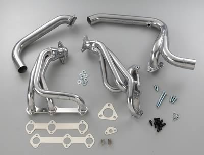

EDIT: Looking at the pictures of the headers, it looks like there is some sort of plug on the passenger side (on ceramic coated and black painted):
Does anyone know if these will work with a stock style cat. converter though? I just put a Magnaflow direct fit on.
EDIT 2: I was right, according to Pacesetter's web site, these headers have: Flanged Collector, Hook-ups for smog & engine management sensors, Comes with header extension to connect to stock system. Fabrication may be required, and 50 States legal.
I may be wrong, but I think the 2.8 and 3.1 smog set-up is different. I think the 2.8 has tubes that put air into each exhaust tube while the 3.1 only has one on the pass. side.
And the plug on the passenger side that you mentioned is for the EGR.
