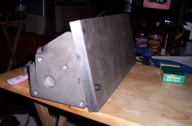

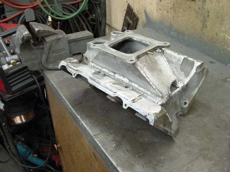

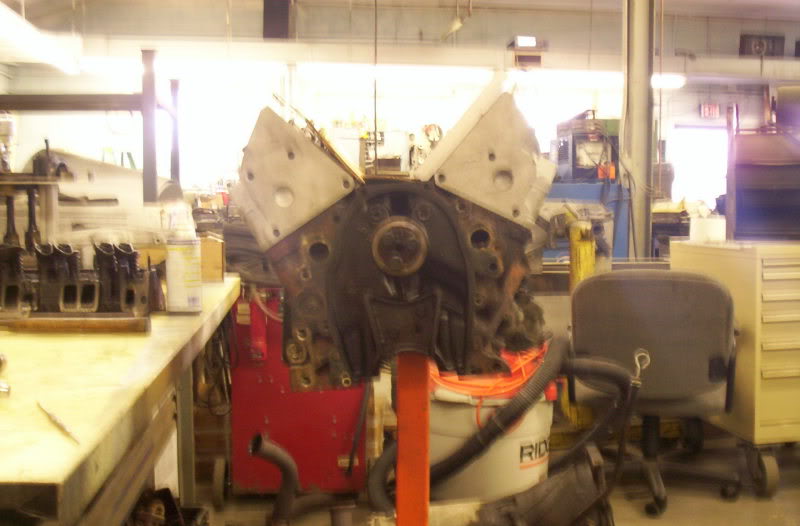

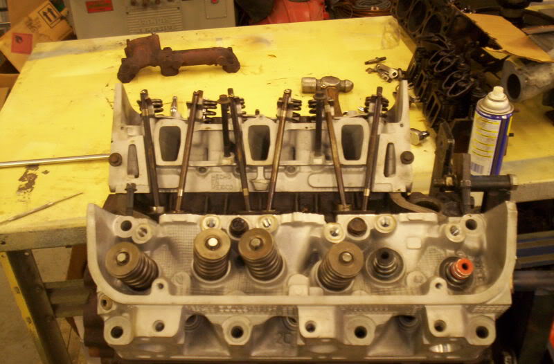

I don't know that I ever spilled the beans on the plans there... just think aluminum heads and a distributor...
wb be nice to see what u come up with pretty sure u still hold the fastest n/a record

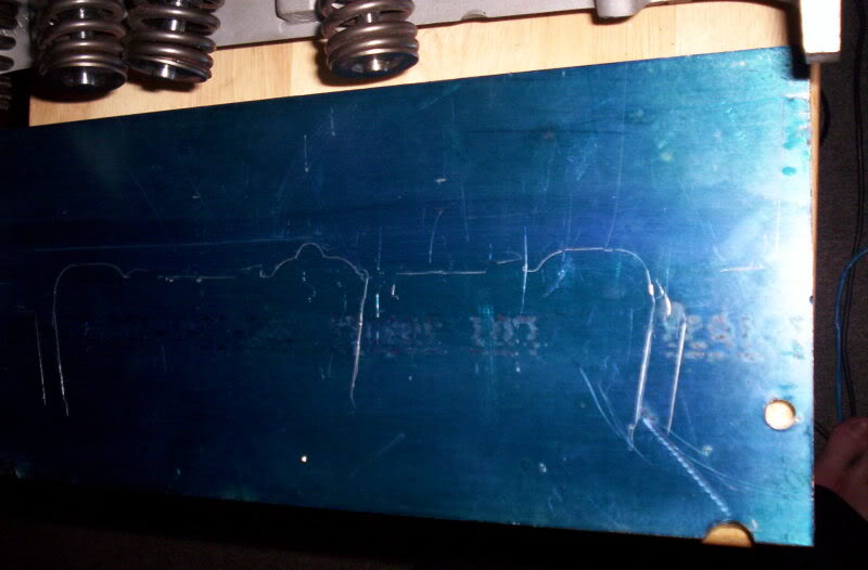

anyways heres some pics of some stuff i worked on should help u out a bit or give u some ideas
lots more to come

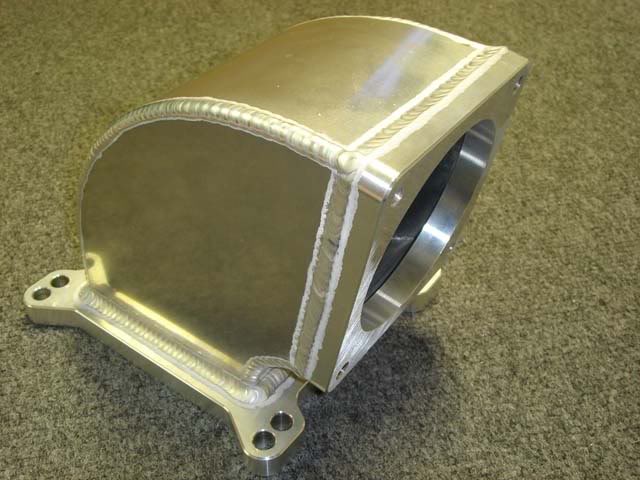

Old Aug 17, 2009 | 08:30 PM

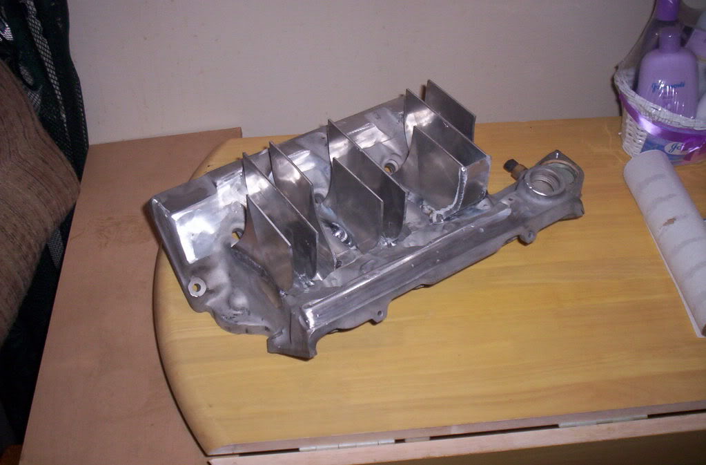

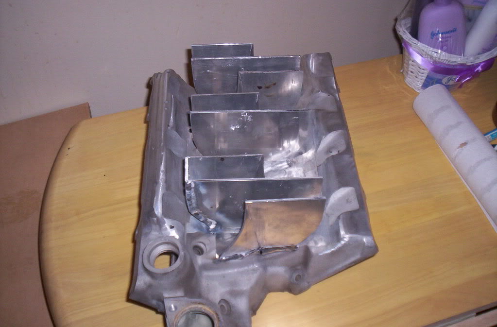

and Name:  100_0993.jpg
i never completly finished it but i did get a lil further then the pics, the plenum sat ontop of the runners basically sorta a halfround plenum
it was a gen 2 intake, if u weld and machine the ports on a gen 2 intake u can get them to match the gen 3 ports

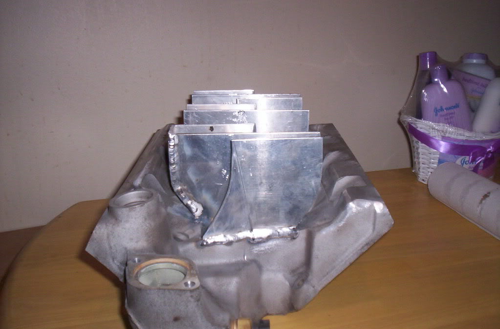

notmine but somone from 6o degree v6
setup for carb and dizzy but withthis and injector holes drilled u could have a nice fi intake

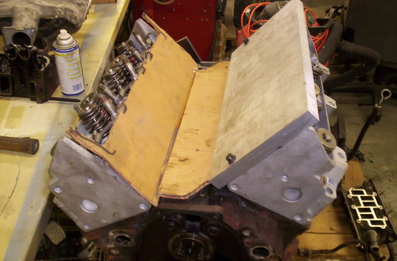

ans this is how a made flanges to build an intake from the ground up
