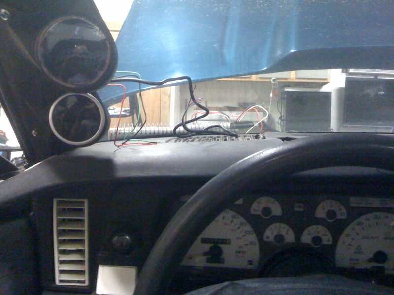

and yet another present from the mail...one dual gauge pod
Attached Thumbnails My 3.4 t3/t4 Turbo Build-gauge-pod.jpg

little update... the boost gauge arrived today and everything else is in the mail except for my megasquirt ecm, ill take care of that tomorrow. so i would say by the end of next week i should have everything i need to bring another Turbo V6 to life

more pics woot
Attached Thumbnails My 3.4 t3/t4 Turbo Build-car-stuff.jpg

looking good only a few more pieces left to come in now

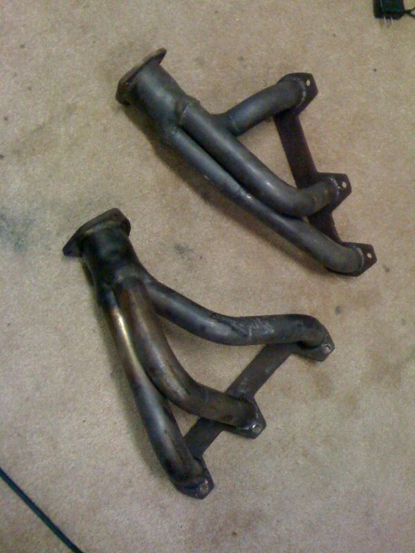

some pics of bends and couplers(just for you dave )
Attached Thumbnails My 3.4 t3/t4 Turbo Build-header-pipe.jpg

thnx man those legs on the bends are a lil short we may have to pick up 2 ft of 2.5 inch stright tube from the parts store, the bends im used to usually have like 18 inch long on each sodes of the bends

i need to make sure the parts stores around here carry 2.5 inch straight pipe...im sure at least one of them does, and i suppose we can hit an exhaust shop early saturday morning if the parts stores dont have anything

FOR SALE!!
Set of Stainless headers for a 2.8-3.4 v6 motor...not emissons legal, pm me if your interested. they were custom made by pf&e and are still in perfect shape.

couple pics...gague pod mounted still have to wire and a couple pics of downpipe and turbo header

Is that a 2 1/2" log style turbo header w/little to no primaries....?

Yea pretty much, hopefully updates tomorrow
