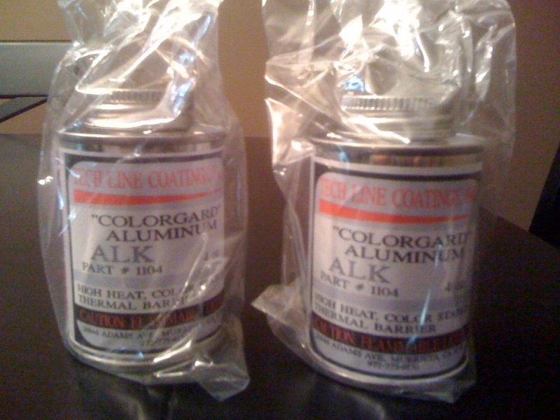

look what came in the mail today
Attached Thumbnails My 3.4 t3/t4 Turbo Build-techline-coating.jpeg
