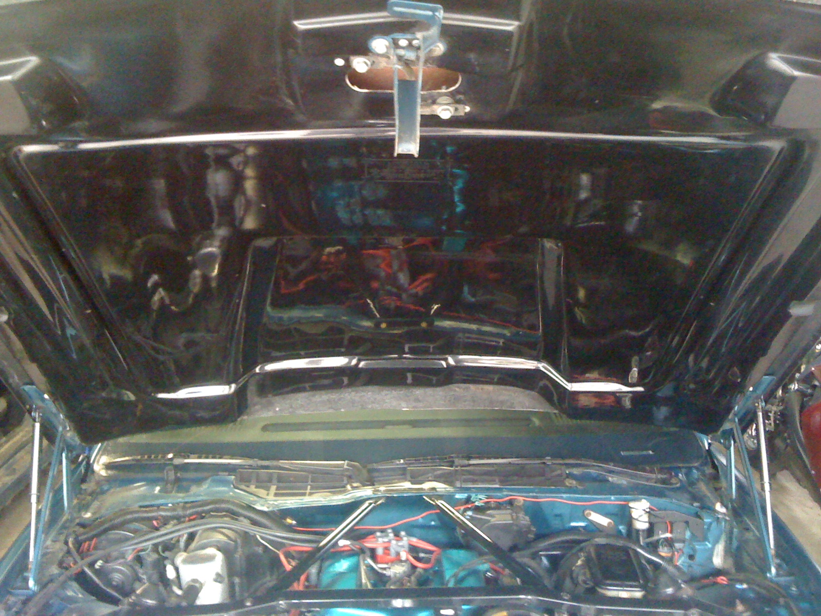

cool man i probably wont get to it till next weekend at best, wish i had remembered to do it while it was apart.
a few more pics as im bored...thanks kev for the dash
and i detailed my hood, it was nasty, now you can see the motor in it
Attached Thumbnails My 3.4 t3/t4 Turbo Build-new-dash.jpeg   My 3.4 t3/t4 Turbo Build-new-dash-2.jpeg   My 3.4 t3/t4 Turbo Build-clean-underside-hood.jpeg

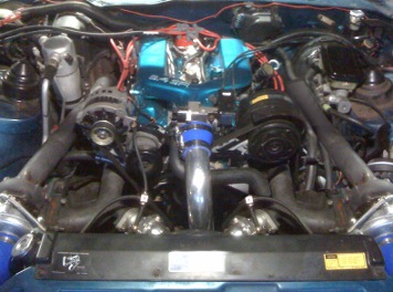

oh **** pils went twins lol
Attached Thumbnails My 3.4 t3/t4 Turbo Build-pilstwin.jpeg
Old Oct 10, 2010 | 11:43 PM
  #322
Pillsbry10's Avatar
Joined: May 2003
Posts: 2,023
From: Evansville, IN
Car: 1992 Camaro RS 25th Anniversary
Engine: 3.4L v6 with a t3/t4 Turbo
Transmission: T-5 Conversion
Axle/Gears: 3.23 SLP Limited Slip
Re: My 3.4 t3/t4 Turbo Build
lol that would look killer
Old Oct 10, 2010 | 11:50 PM
  #323
project89's Avatar
Joined: Apr 2008
Posts: 10,401
From: Utah
yeah it would was playing around with photoshop to see what it would look like im starting to rethink my single s475 , thinking about twin gt35r's since i have a lil cash i can burn
twin ball bearing gt35's would spool up lighning quick on a 3.0L motor

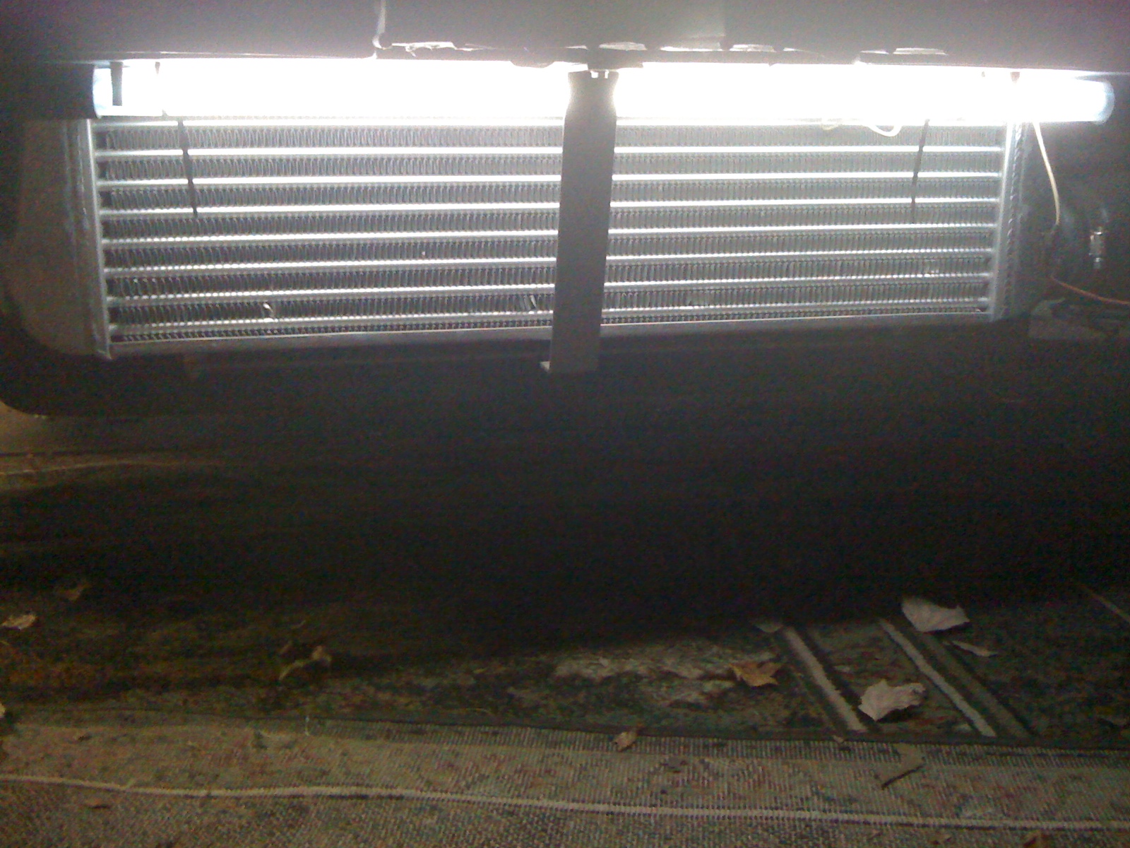

so i did a free mod this evening, i re-hooked up my street glows. yes i know most of you hate them but hey it lights up the intercooler
and it gives me a extra light under the car to work on it
