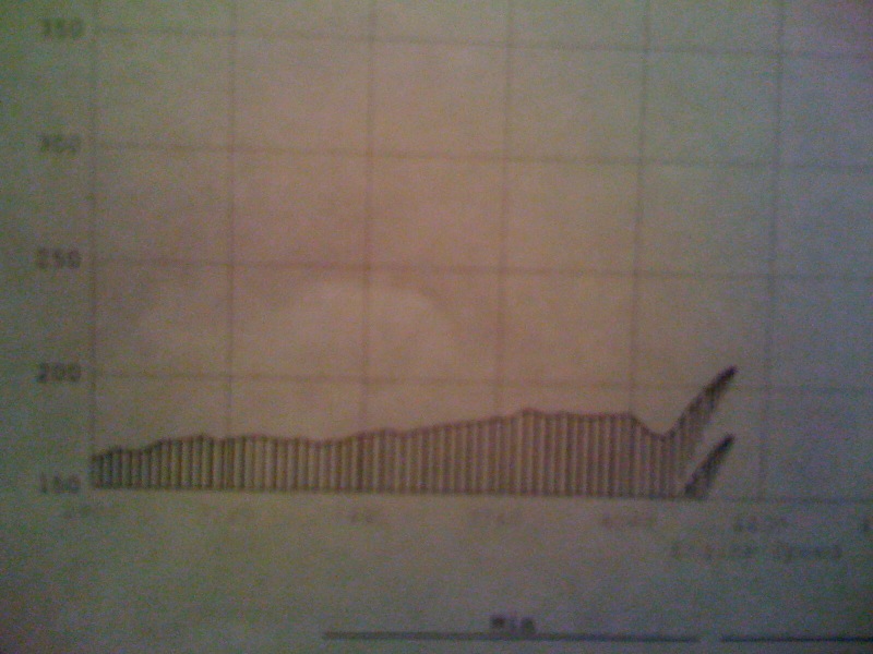

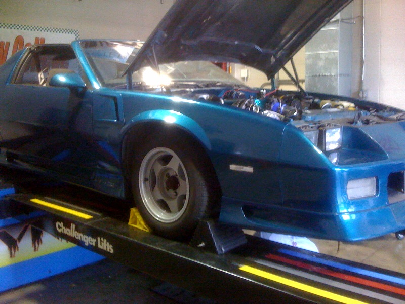

ok so today i went and put the car on the dyno to get a rough idea as to what the car was running n/a and at low boost. however the clutch pretty much gave up as soon as it got into boost so these numbers from what i can tell are all motor
174.6hp and 210tq @ 4332 rpms(which is when the clutch slipped) at 1/2 to 3/4 throttle
my full throttle run just blew the clutch out
not great but not to shabby with pretty much 0 boost, and i couldnt get it any higher than those rpms so i still had a lot left. this should give you guys an idea of what the 3.4 is capable of. i was hoping for closer to 200hp and 250tq on motor alone but its close. i wonder if i wouldve gained more if i couldve got the rpms up on it.
the graph shows that its still pulling hard as boost kicks in so who really knows what im gonna get number wise with a clutch and 10-15psi
thats a 41hp and 35tq gain over my 3.1
this is also with a bad exhaust leak and a safe tune
Attached Thumbnails 3.4L Dyno Run part 1-dyno.jpeg   3.4L Dyno Run part 1-dyno-graph.jpeg

hp and tq was only at 35% throttle and about 1 psi of boost not even
picture below shows were he got out of it
get a few issues cleared up and u should b looking at around 290ish rwhp and 350rwtq @ 5 psi if not better that car is going to be a beast once the boost gets turned up
u need to get a new dyno guy, seriously the wideband was well into the danger range 18.0 afrs and he still went for the pull.granted something happened and the wideband went out but had it been reading correctly that could have cost u a motor.
\ the car is overly rich and throwing a false lean condition i gota go threw the logs better but they show a 18ms pulse width on 48 pound injectors which shouldnt be so its way rich.
im 90% sure this is form the antirev system settings being way toi strict cause that system actually pretty much makes the motor go dead rich and pulls back timming to kill off power to stop it from revving up. so for now switch back to the defualt-safe.msq file. once u do that u will have to reload the ve and spark tables again use the updated spark and fuel tables the n1 files with the defualt msq file
btw can u post the dyno gaph please

yeah they arent the best dyno people but they get the job done, i was trying to watch my afr and my tach at the same time and listen for the clutch to go lol
ill post that graph later, its real small and hard to see i dunno if i can get a good pic of it

posted pic of graph..not a great pic.
yeah i didnt feel like it was the max of what i was going to get out of it, but at least it gives everyone an idea

heres some odd info lol pull stoped at 100 mph it took 4.2 seconds to go from 60mph to 100 mph at part throttle
Old Jul 27, 2010 | 10:39 PM
project89's Avatar
Joined: Apr 2008
Posts: 10,401
From: Utah
Re: 3.4L Dyno Run part 1
its deff rich check out the duty cycle and fuel flow at the bootomg of the grapgh
