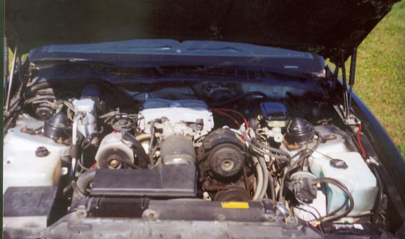

Now, how can that be adapted to a 1986 Firebird with a MAF and that little sensor thingy??
Old Dec 25, 2001 | 11:52 PM
Black 86 'bird's Avatar
Joined: Nov 2000
Posts: 398
From: Southwest Ohio
Car: 1986 Firebird, 2000 WS6
Engine: 2.8, LS1
Transmission: 700R4, T-56
Axle/Gears: Stock, Stock
Who's engine compartment looks like this:
My engine bay looks like that. I had a theory on this setup and what I was going to do was the same idea except attach the MAF sensor inbetween the front of the intake, and the end of the PVC, like this:
Camaro_hunter_d I was wondering if you could take a picture upclose of where the PVC joins onto the Intake?

Old Jan 5, 2002 | 08:12 PM
89camaroRSV6's Avatar
Posts: 811
ok guys .... what happens if u have a MAF sensor and a IAT sensor .... i dont have enough space in the front to mount that Y tube ... os my MAF to radiaor distance is very small
89 camaro has a MAF running to a dual intake ...
and how good are fram 7017
is it just for testin or are u guys gonna run that one

The Fram filters are PURELY TEMPORARY( I HATE FRAM IT'S ( RAP) I am working on getting to heat shielded reatives to fit inline with the Y.

ok guys ,,,
my car under the hood looks like (its from a v8 someone 's v8)
but its the same intake system....
do u want me to abandon waht i have and go with the pipe going to the side....
or do u want me to cut the airbox below this

Thats a good setup but there is better. Something that might make yours better is get a heat shield blanket thing from summit and cut it and put it under the intake so the radiator doesnt make it as hot. Just an idea.

I would not abondon it yet. I would try it. Then if you want try this later. You may notice a difference between the 2 of them.
If you go to my website that posted somewhere above you will find how I did mine. I did not have that setup you posted the pic of, I would think that the plastic would get hot no matter what you did cause it makes contact with the radiator(You can some what shield the intake air from the rad, but you will get conductive heat no matter what you did so I think what I and Monkey did is a better design, I just took it further), and you cant move it so it does'nt. Mine runs about 2-3 inches behind the top of the rad, so I know it does not get very hot. After I get the $$$ for the 2 reactives I am going to hook those up and then after I get more $$$ I am going to have the entire system remade in exhaust tubing(3") and have that wrapped in heat shielding.
