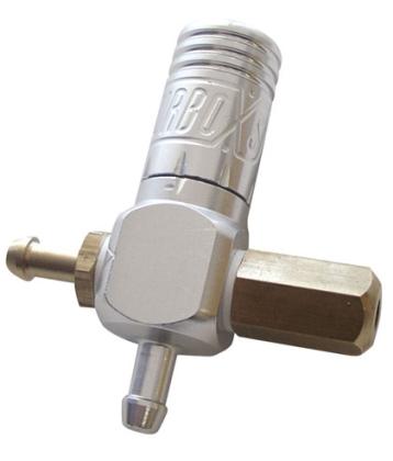

he is using the boost control built into the ecm.
i personally prefer an turbo xs high performance manual boost controller
this one
has the spring loaded ball to decease spoolup time , then bleeds air uptop to raise boost.
this one
never had an issue with mine and never got fluctuating boost levels or boost spikes with it
i quess im old fashioned though i prefer mechanical boost control over electronic
though in my twin turbo iroc i will be using ecm based boost control based on time/speed at the track so i can run a small tire
15 psi in first
20-25 psi in second
18 psi + nitrous in third
though i may get the turbo xs 3 stage manual controller and wire up my ecm to control the stages

i had good luck with the greddy electric boost control where you can make adjust to control boost spikes an turbo spool . i just didn't like the manul cause i didn't like pulling over to adjust it .lol . i havent dug into the ebl flash far enough to see if i can control boost with that or not .
